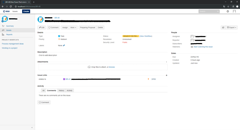

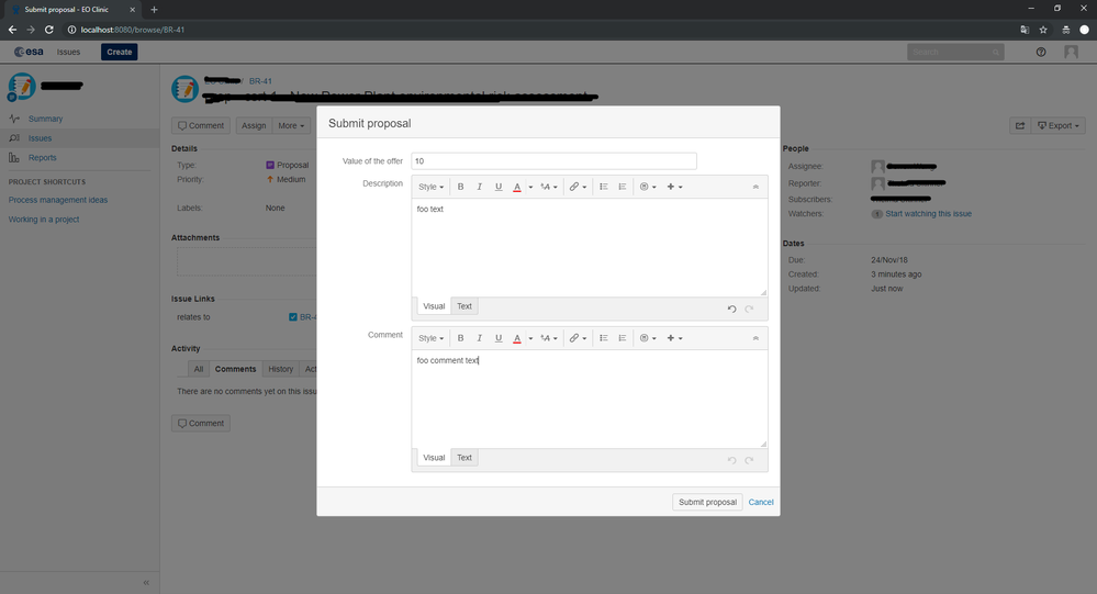

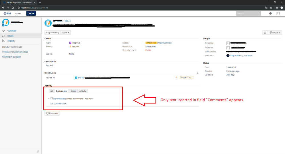

I have linked issues (issue B) inside issue A (image1). When I transition Issue B from one status to another it opens my customized screen (image2). For example if I add comments (in the default field) in this screen I get those on issue B.  However, if I add data to the other customized fields I don't (image3).

image3 shows only the comments area of B, and it looks like the description has updated from the transition fine.  I can't tell about the numeric field, it looks like it is not on the issue view screen for the issue type that B is.
