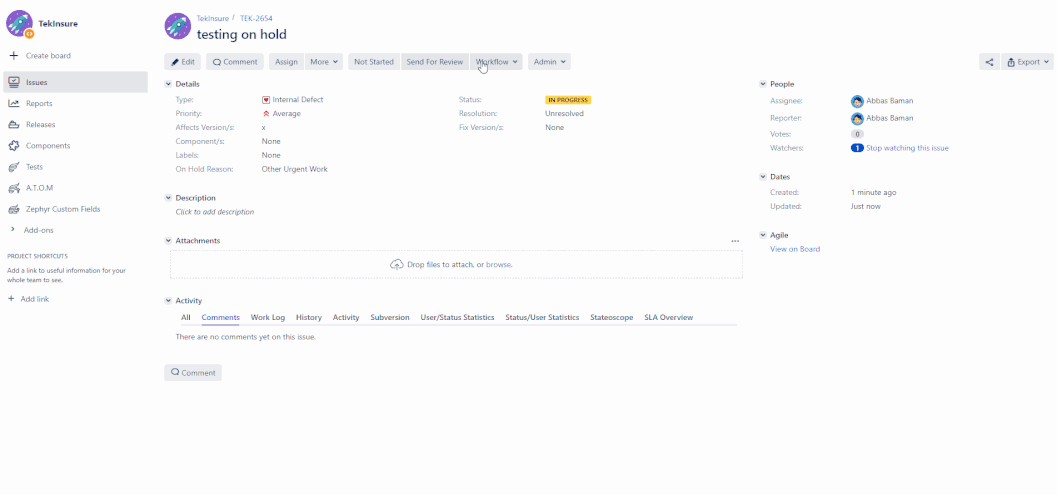

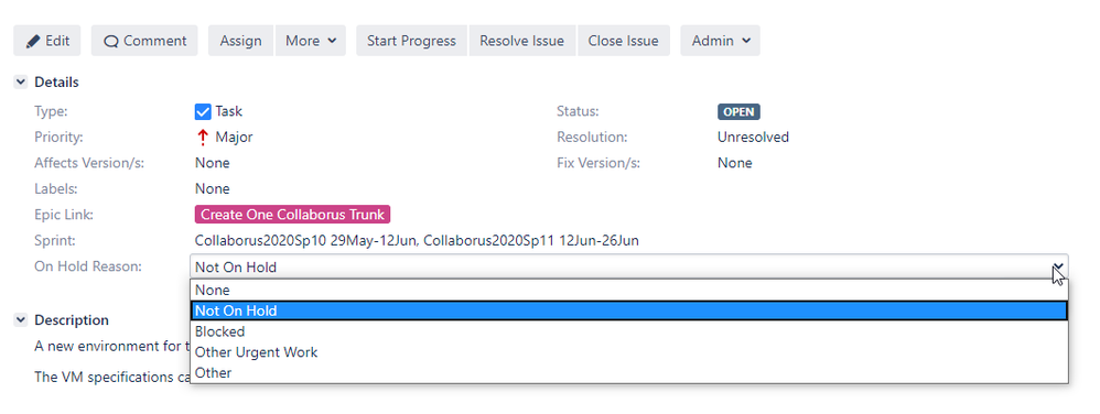

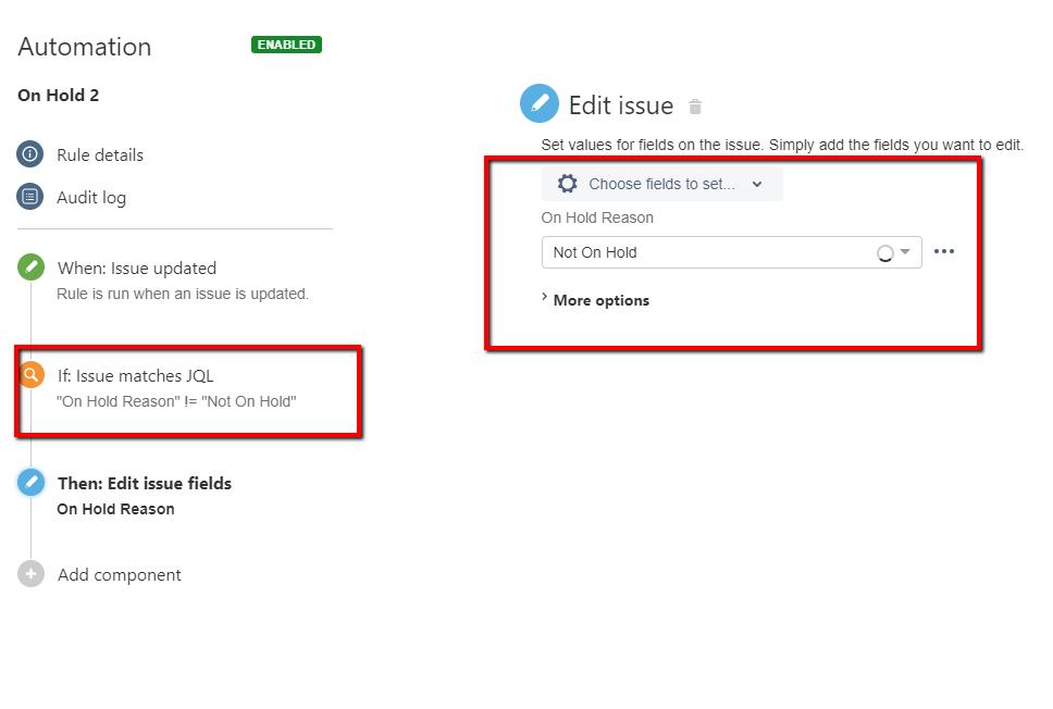

When transitioning from 'on hold' status to any other status, the 'on hold reason' should automatically change to 'not on hold'
@Callum Carlile _Automation Consultants_   @John Funk
can anyone please help me to resolve this

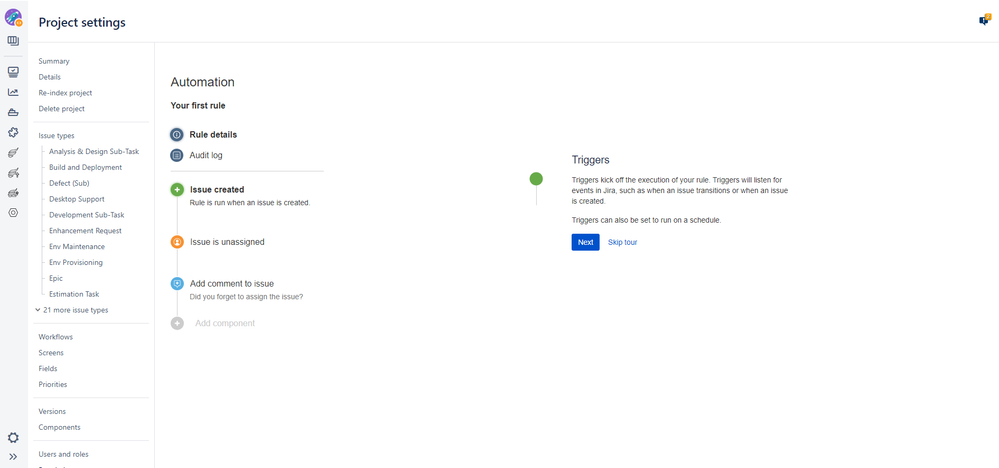

@abbas baman ^ ScriptRunner would be a good option. If you weren't as comfortable with scripting then Automation for Jira is an alternative:
Full paid version here
Free version here (I believe you get 300 free rule executions per month so this may be enough)
You can set a trigger (e.g. Issue transitioned from A to B, leaving B blank to match all statuses) and an action (Update a custom field on an issue to match your criteria). You would also need to set up a second rule to clear this value on transitions in the opposite direction

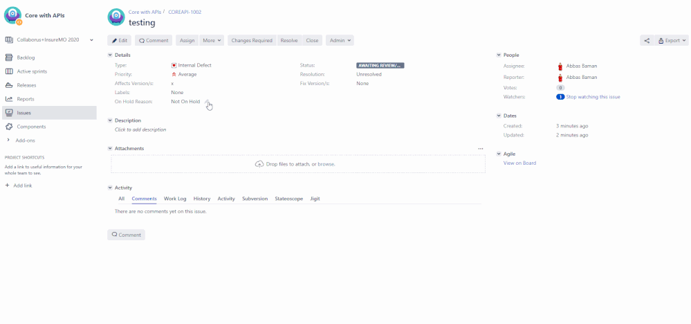

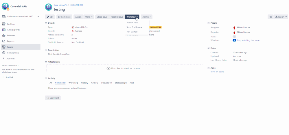

abbas baman
June 24, 2020

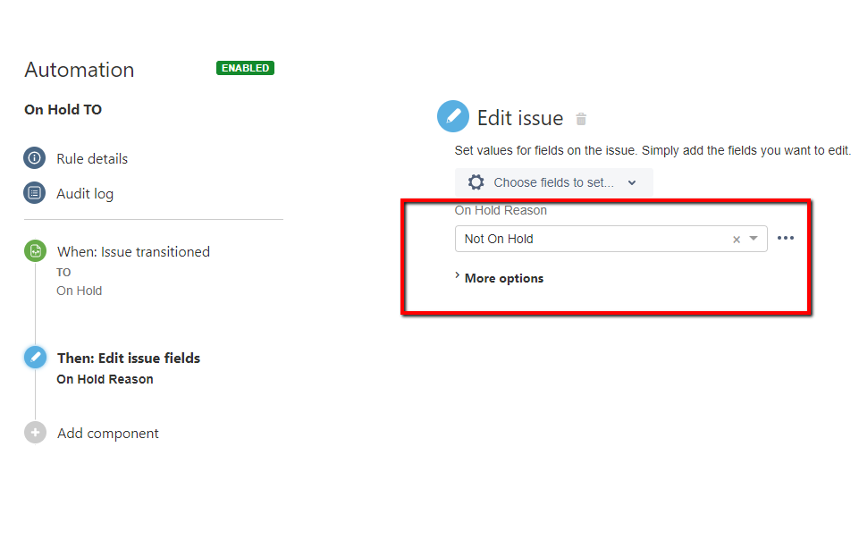

Hi @Callum Carlile _Automation Consultants_  its working the opposite when I set status to 'on hold' it is automatically changing 'on hold reason' to 'not on hold this does not make sense when a status is changed from 'on hold' to something else, then the 'on hold reason' field should change to 'not on hold'
June 25, 2020
In the Action in your screenshot above, double check that the On Hold Reason is being changed to 'Not on Hold', as you have set the trigger as 'When issue is transitioned from On Hold'.
You will need 2 rules,
  1. When the issue is transitioned TO On Hold, the On Hold Reason field is changed to On Hold
  2. When the issue is transitioned FROM On Hold, the On Hold Reason field is changed to Not on Hold

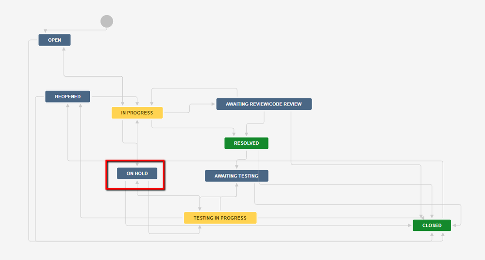

Hi @Callum Carlile _Automation Consultants_  'on hold' is transition and 'on hold reason' is a custom field which has four value as  you can see in the above screenshot so my requirement is "When transitioning from 'on hold' status to any other status, the 'on hold reason' should automatically change to 'not on hold; " how to achieve this
July 4, 2020

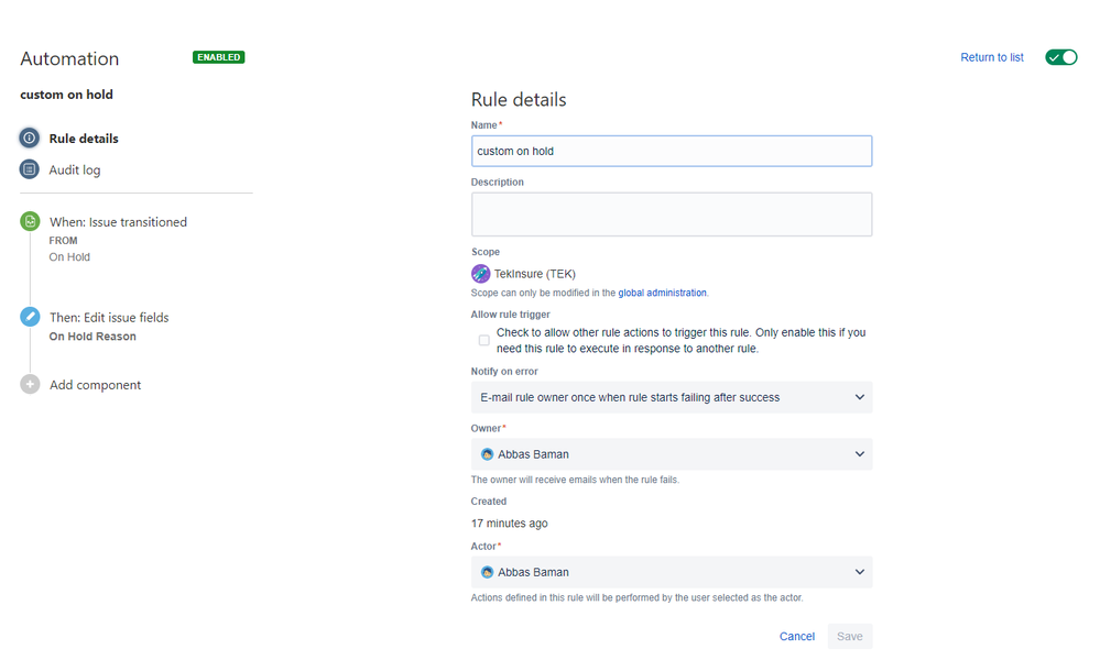

@abbas baman Based on your screenshot, it looks like 'On Hold' is a status, (the transitions are the arrows between statuses. Here's what you need to do:
  1. Create a project automation rule (via Project Settings > Project Automation)
    1. Add a Trigger of when an issue is transitioned (From On Hold, then leave the To field blank)
    2. Add the Action of Edit field value, select your On Hold Reason custom field, then select the Not on Hold value
    3. Give the rule a name and publish it
This will give all issues transitioning from the On Hold status > all other available statuses an On Hold Reason value of Not On Hold

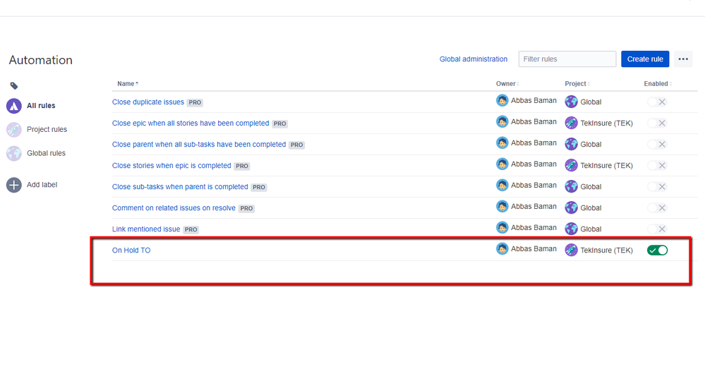

abbas baman
July 5, 2020
Hi @Callum Carlile _Automation Consultants_ it is working fine but one more thing it is only working for me is it because I am system admin not for another user2020-07-06_0846.png could you please help me to resolve this thanks a lot
abbas baman
July 6, 2020
Hi @Callum Carlile _Automation Consultants_ could you please help me to resolve this issue
July 6, 2020
@abbas baman This rule should work for all issues in the Tekinsure project, you're listed as the owner of the issue but if someone else transitioned an issue in this project then the rule will still apply

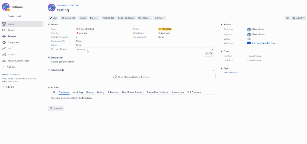

Hi @Callum Carlile _Automation Consultants_  it is working fine when I am changing the status from 'on hold' and from that 'on hold reason ' but when I directly selecting 'on hold reason' from drop-down it is not changing could you please check the GIF and help me out
July 7, 2020
@abbas baman That's because it's not set up to do that.
The automation rule's trigger is when the issue is transitioned, which causes the action of changing the field value.
If you want to transition the issue when you change the field value, you will need to create another rule where the trigger is the field value changing, and the action is the transition

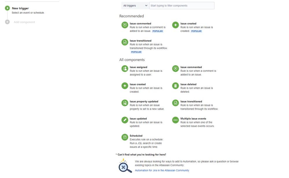

abbas baman
July 7, 2020
Hi @Callum Carlile _Automation Consultants_  i am not able to find field value trigger could you please tell where i can get that  2020-07-07_2141.png
July 7, 2020
It might be missing if you're using the lite version for automation for Jira. You can use the Issue Updated trigger instead, then the filter mentioned above should still cover it

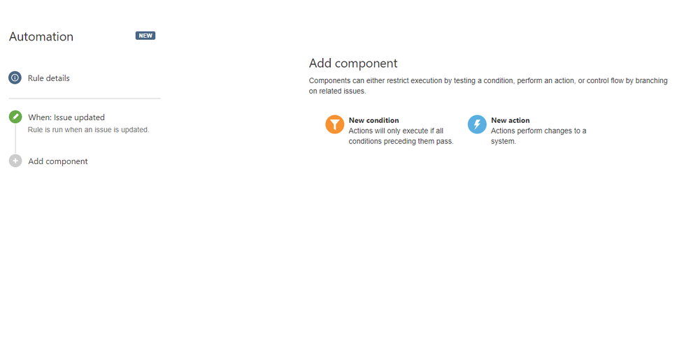

abbas baman
July 7, 2020
Hi @Callum Carlile _Automation Consultants_  sorry to disturb you again and again but i am totally new so that why thanks for your support so far but with updated trigger what was the next step could you please show me after issue update trigger showing like this 2020-07-07_2151.png
July 7, 2020
@abbas baman The next steps will be the same as I mentioned above:
  1. Add a new condition - use the JQL filter component to filter out all values that aren't "Not on Hold" (add "On Hold Reason" != "Not On Hold" to the JQL text box)
  2. Add an action to transition the issue to the status you want to transition to

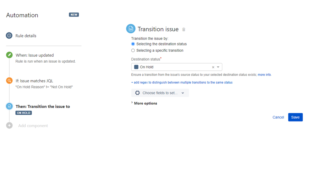

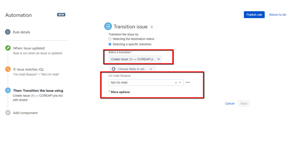

abbas baman
July 7, 2020
Hi @Callum Carlile _Automation Consultants_ is this right could you please 2020-07-07_2231.png
abbas baman
July 7, 2020

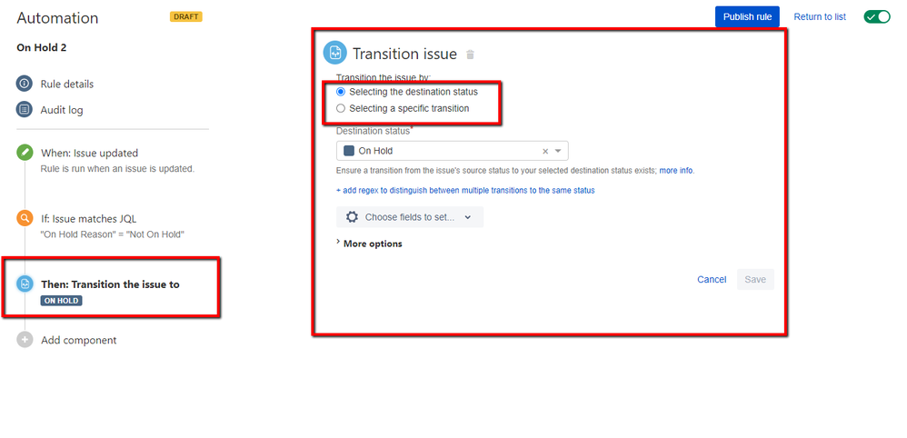

Hi @Callum Carlile _Automation Consultants_ I am confused in your second point I want to achieve
whenever'on hold' status to any other status, the 'on hold reason' the 'on hold reason' should be 'not on hold'
July 7, 2020
@abbas baman In that case, enter the JQL
"On Hold Reason" = "Not On Hold" for the condition (remove the ! from your the condition in your screenshot)
Then for the action, select the transition action to transition the issue from On Hold --> all other statuses which On Hold transitions to.
In your screenshot, you're currently transitioning the issue TO On Hold, but you want to transition the issue away from it, as the issue will already be in On Hold

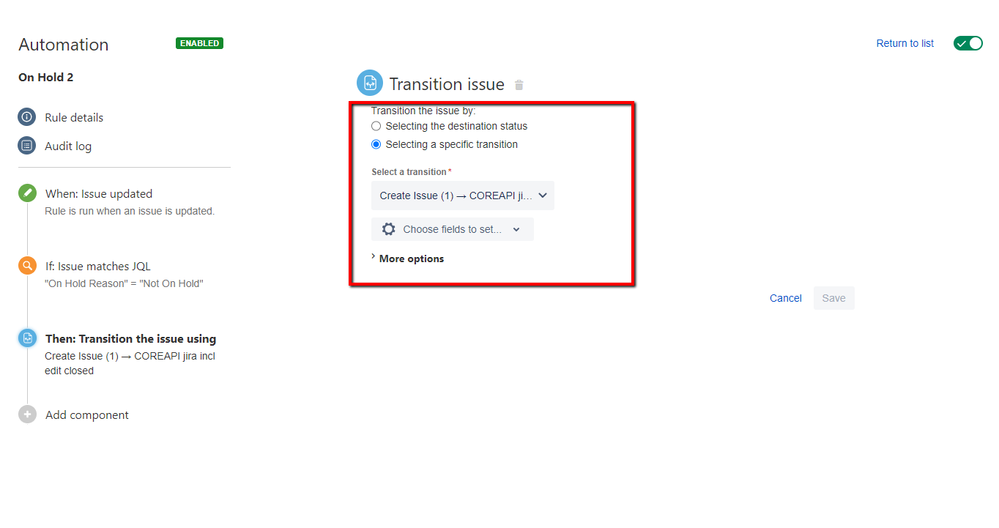

abbas baman
July 7, 2020
Hi @Callum Carlile _Automation Consultants_  please check GIF and guide me what Ijiraaqwewedwd11.gif need to choose
July 7, 2020
@abbas baman No this is not right, you have selected the create transition, os the rule will not work.
In the gif you sent earlier, you said that when you change the On Hold Reason field value to Not On Hold, you wanted the issue to automatically transition from On Hold. THIS transition, from On Hold --> Some other status, is the transition which you need to enter as the action here.
And you do not need to set the field value to Not on Hold in the action, as this is the trigger for the automation, so it has already been changed.
July 8, 2020
@abbas baman You just need to select the second checkbox (specific transition) and add the transition that you're wanting to transition the issue to.

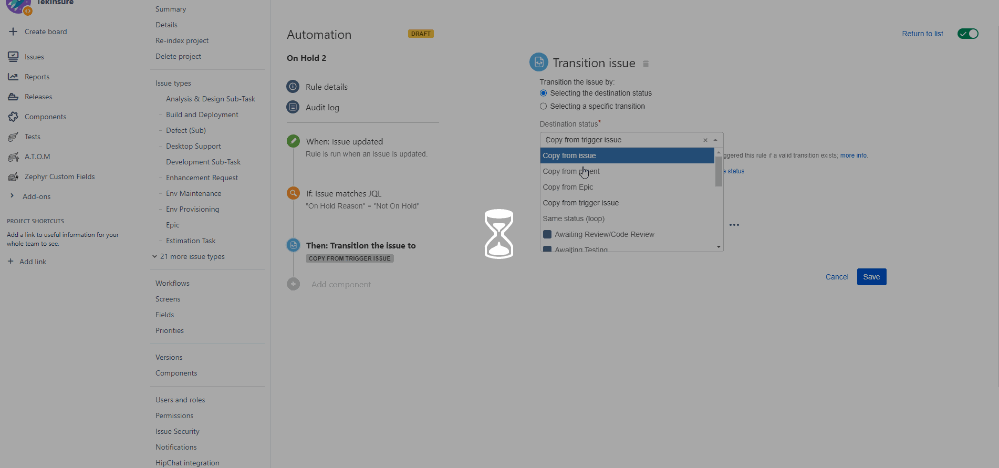

abbas baman
July 8, 2020
Hi @Callum Carlile _Automation Consultants_ I have followed what you have said as you can see below gif when I am changing 'on hold reason' from the drop-down list and when the transition is changed the 'on hold reason ' is not automatically changing to 'not on hold.
please check below automation which I have set for this as you told
abbas baman
July 9, 2020
Hi @Callum Carlile _Automation Consultants_  did find any thing
July 9, 2020
@abbas baman In that case, you will need to set the On Hold Reason field value in the action to Not on Hold.
Also You might want to re-look at the transition you've selected, as this is different from what you previously explained. You have selected the Create issue transition
