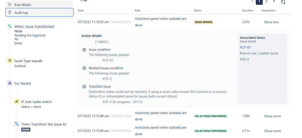

when it was simple work flow, it worked like the same, but now its not working and constantly showing some error, please help how i can proceed this, Find the attachment below,
Mark Segall
October 7, 2022
Hi @NANDHANA_VAZ - You'll need to review the parent workflow.  It is likely one of two things has occurred:
  1. The transitions have become more stringent where the parent must be in a specific status before transitioning to Done and your parent issue is not in this status when the rule executes
  2. The destination status has changed (e.g. The parent now uses a status like Closed instead of Done)
So, you'll need to do a little bit of digging to see what changed in the parent workflow in order to adjust the rule accordingly.

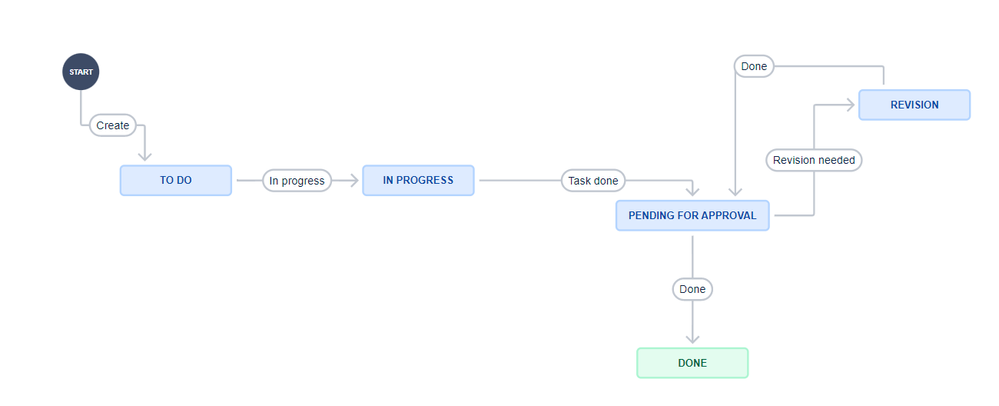

NANDHANA_VAZ October 7, 2022
Mark Segall
October 7, 2022
Ok - So this is a team-managed project, correct?
It appears that PENDING FOR APPROVAL is still the only status that can transition to DONE.  So, you'll need an issue field condition in your branch:
status = Pending For Approval
Without the condition, the rule will fail any time the parent status is something other than that.

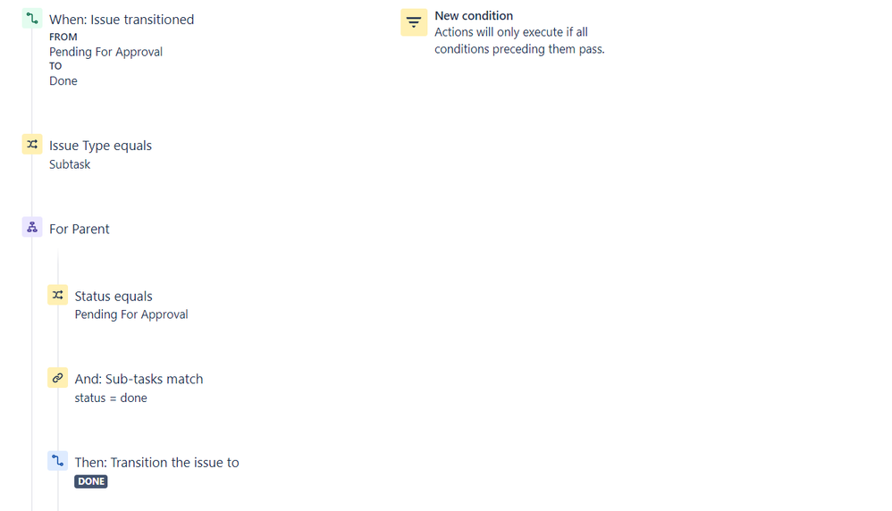

123!!.PNGLike this you meant, please correct me! i was trying to sort out this for quite long time.
Mark Segall
October 7, 2022
Yes - That should work.

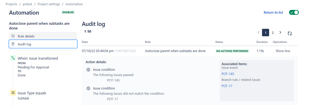

Getting the status as No action is performed, what can be done now? please guide!
Mark Segall
October 7, 2022
It is exiting out because the parent issue is not currently in the status PENDING FOR APPROVAL.
