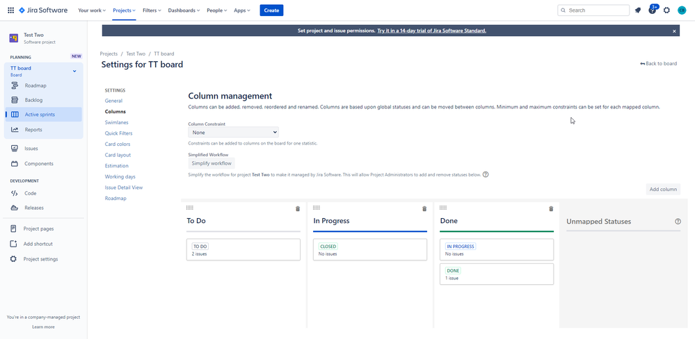

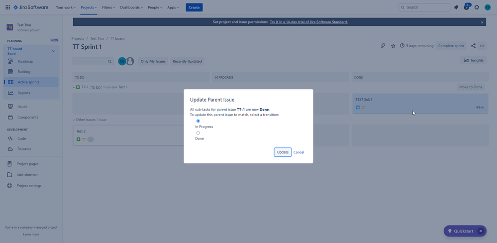

I believe it will only prompt you to close the Parent if the "Done" statuses are in the right-most column of your board.

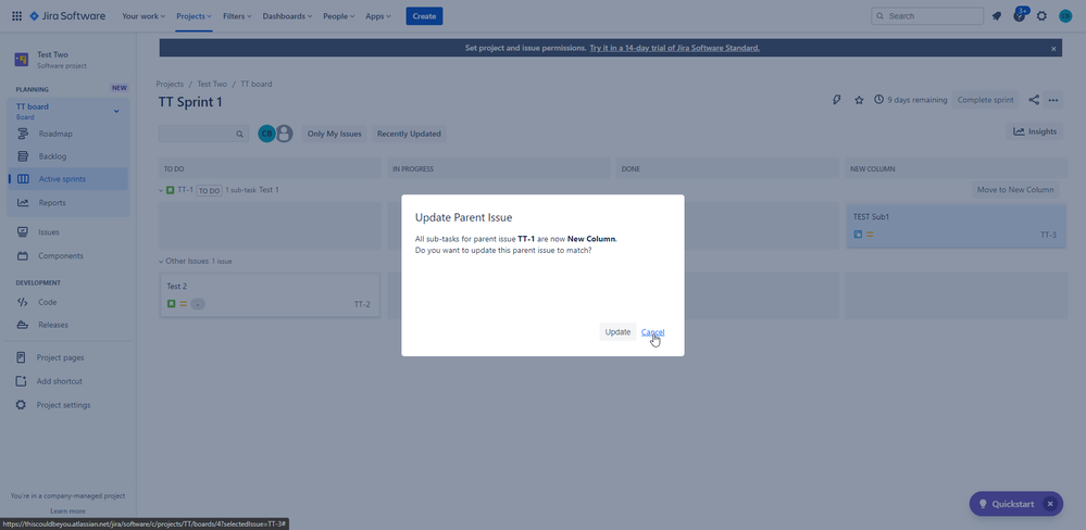

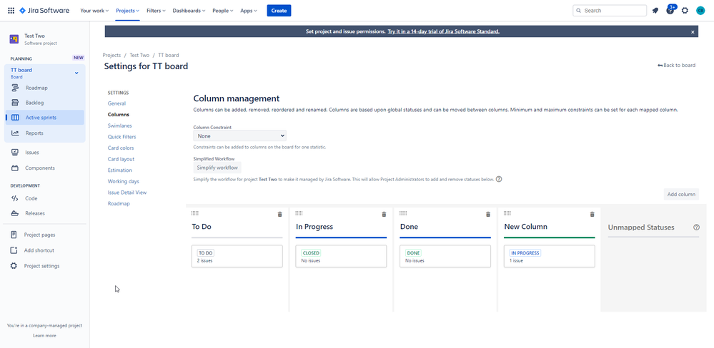

EDIT - I just messed up my board intentionally - the prompt will transition parent tickets into whatever status is in the right-most column. It doesn't matter what status-category that is. It will just ask if you want to update the parent to match the available statuses
It's possible there is something more complicated in the workflow that prevents the popup, but this is the first thing I'd check.
