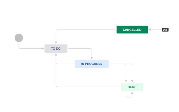

The cancelled status is a resolution state if I'm not mistaken so that shouldn't affect this right? (see screenshot)

Sorry, I went for explaining the logic over giving you the JQL that does what you need.  But I'm not 100% clear on that, so I'm not sure what to give you.
Could you explain what you're trying to do with this quick filter - is it "hide all the issues of type "story" or "sub-task" on the board that are in status "cancelled"?"
