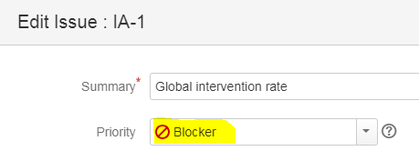

I have issues with the field Priority not set.
They are correctly displayed with no Priority.
However, when bringing them up to Edit, the Priority field shows a different value.

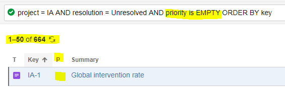

I have reproduced this on our instance.  Searching for issues where Priority "is EMPTY", and then editing one of those issues.... The priority field is shown on the Edit screen and 'Critical/Blocker' (our top priority) is preselected.
I can only assume that this occurs when the Priority field is added to a screen after the issue was created?  Does seem like a bug to me.

Just a caveat to this, I am unable to create issues with no priority value, even when the priority field is not on the screen using normal create.
Some of the issues in our instance that do not have this value set (to the default) were created using a CSV import.  Some, however, look like they must have been created using normal create.  However, I don't know how to recreate that scenario at the moment.

There is actually no problem here. The priority field does not take null values. It always pre-selects the first value in the drop-down. So, if a user wants to keep Null values, they should remove the Priority field from the issue edit screen.

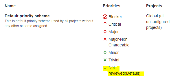

The default priority is "Not reviewed".
It is pre-selecting "Blocker" even though it should be empty.
Nic Brough -Adaptavist-
September 11, 2018
The defaults only apply on issue create.  Otherwise, they would overwrite a value incorrectly on most edits.
