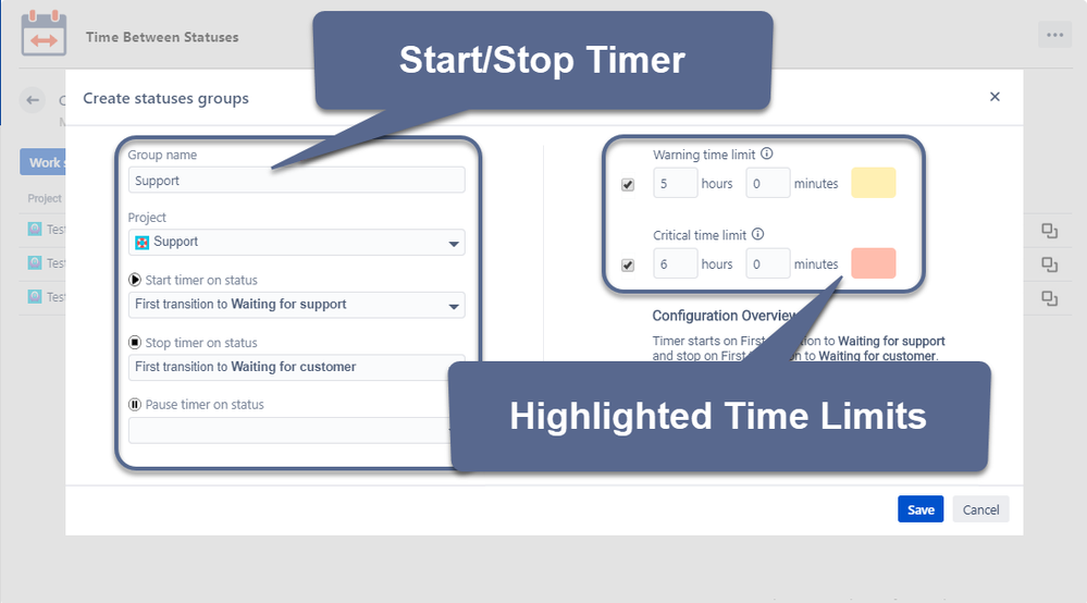

Time between Statuses becomes handy in your case. This add-on calculates time the issue has been spent between statuses and allows you to calculate time exactly from the status you need. You can select statuses to pause and stop the calculation.

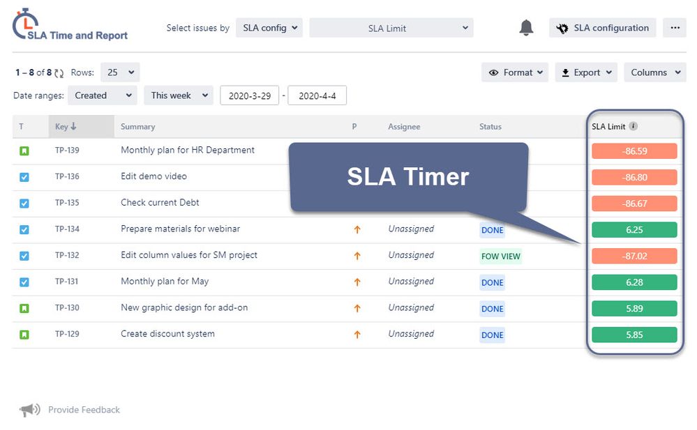

SLA Time and Report sets the SLA timer based on the issue field. So, the timer will start exactly after the transition to the desired status. It determines the time when you issue has been created and whether it is opened now.
These two applications allow you to set time limits and report violations. You can read more in the marketplace.
I hope, this info becomes helpful for you. If you have any additional questions, don't hesitate to contact me.

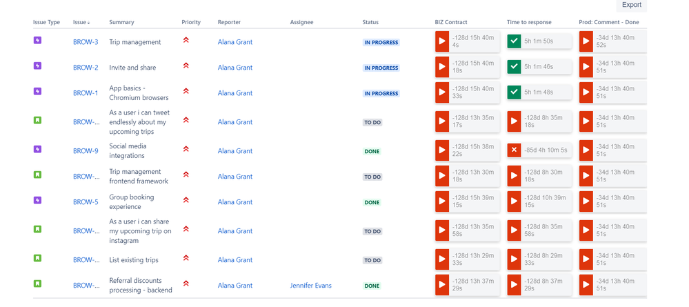

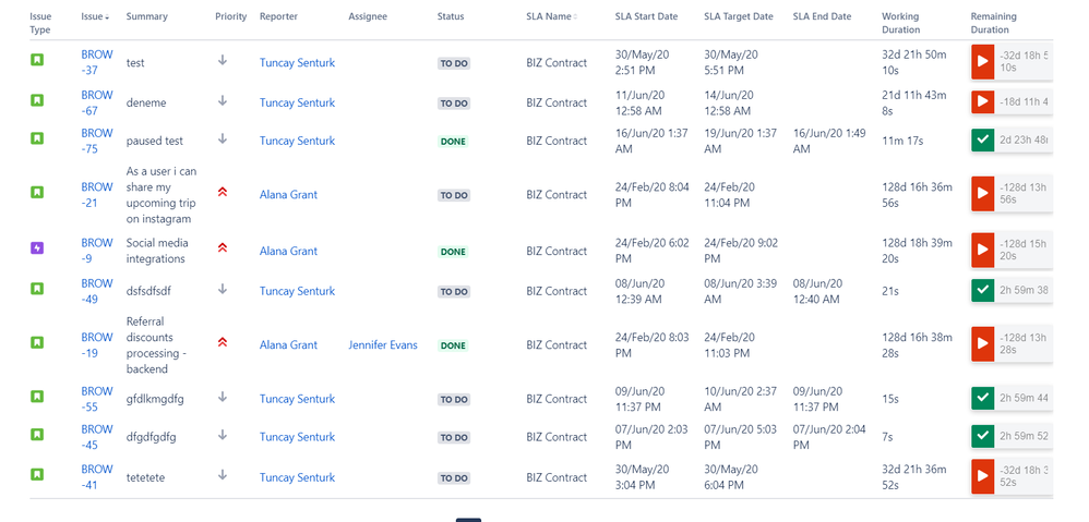

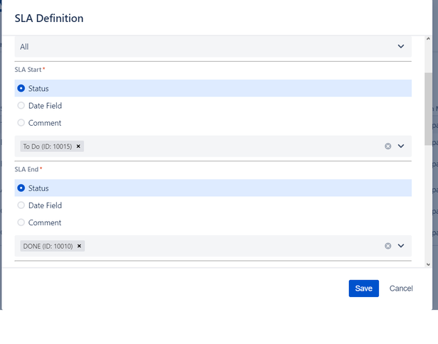

For easy to use and customizable SLA management in Jira Core, Software, and Service Desk, I suggest using Time to SLA.
You can define Resolution time SLAs as it fits your use case, such as starting when it moves to To Do column to the Done column with Pause statuses.
SLA Config To do.pngAfter you generate SLA data, you can generate summary reports and detailed reports for your issues to keep on top of your SLAs.

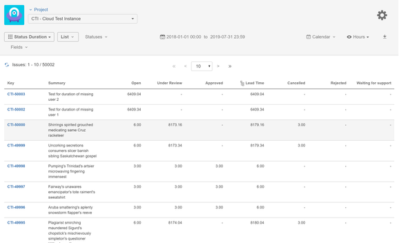

If you are interested in a ready built solution, our team at OBSS built Timepiece - Time in Status for Jira app for this exact need. It is available for Jira Server, Cloud and Data Center.
Time in Status allows you to see how much time each issue spent on each status or assigned to each assignee or group. You can combine statuses into consolidated columns to see metrics like Age, Resolution TimeCycle Time or Lead Time. For these metrics, you can individually select which statuses to include or exclude. All durations can be display in various formats including days, hours, minutes even seconds.
The app can calculate averages and sums of those durations grouped by issue fields you select. (For example see the average InProgress time per project and per issuetype or see the sum of InProgress time per component).
The app uses Jira issue histories to calculate its reports so you can use the app to get reports on your past issues as well.
The app has custom calendar support so you can get your reports based on a 24/7 calendar or your custom business calendar. (This one is important because a 24/7 calendar in most cases shows misleading data. For example an issue created at 16:00 on Friday and was resolved at 09:00 on next Monday seems to stay open for 2,5 days but in terms of business hours, it is only a few hours. You can see this using Time in Status by OBSS.)
