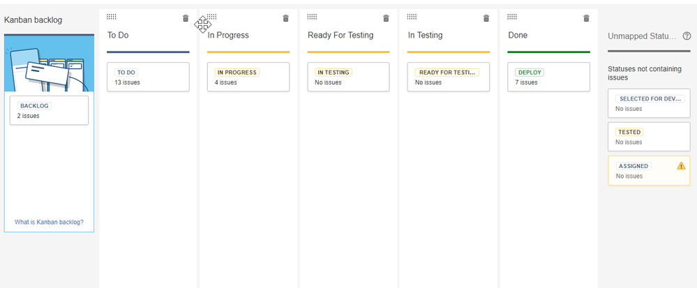

Hi Jack,
Thank you for your quick response, the 'To do' status is on the to do column on the kanban.
Example:2018-01-16 15_16_59-ePack - Agile Board - JIRA.png
Does this setup look correct to you?

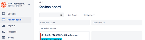

So the issue here as I stated is that you have To Do column on your Kanban board. That is why it shows there. The question is what do you want it to do. What does your workflow look like? Is To Do the first status when created? Do you have backlog feature enabled on your project, i.e. do you see "Backlog" in the side bar as below? As you will see in my example To Do does not exist on my board because I associated it to my backlog.
Another thing I noticed in your image is that you have several unmapped statuses. Unsure if that is desired or not.
