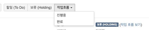

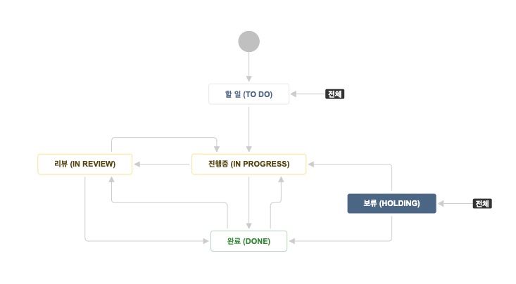

When changing 'To-do → Hold → To-do', it remains as 'Complete'.
1. When changing 'To-do -> Hold -> To-do', it remains as 'Complete'.
2. It has never been changed to a completed state.
3. Please remove the done icon when transitioning to To Do status.
I've been experiencing this problem for 3 years.

Have you looked at the Post Functions and properties of the workflow?
The check mark on a sub-task indicates a resolution which is different than the status. It doesn’t care what the status of the task is. If a resolution has been set by something, and then never cleared as you transition to other statuses, that could be a reason why the issue appears to have the check mark.
To confirm, check if there is a resolution on the Checked task. If you need more guidance, make sure to include the Post Function associated with the various statuses in your workflow.
