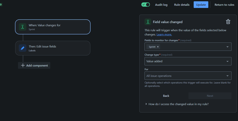

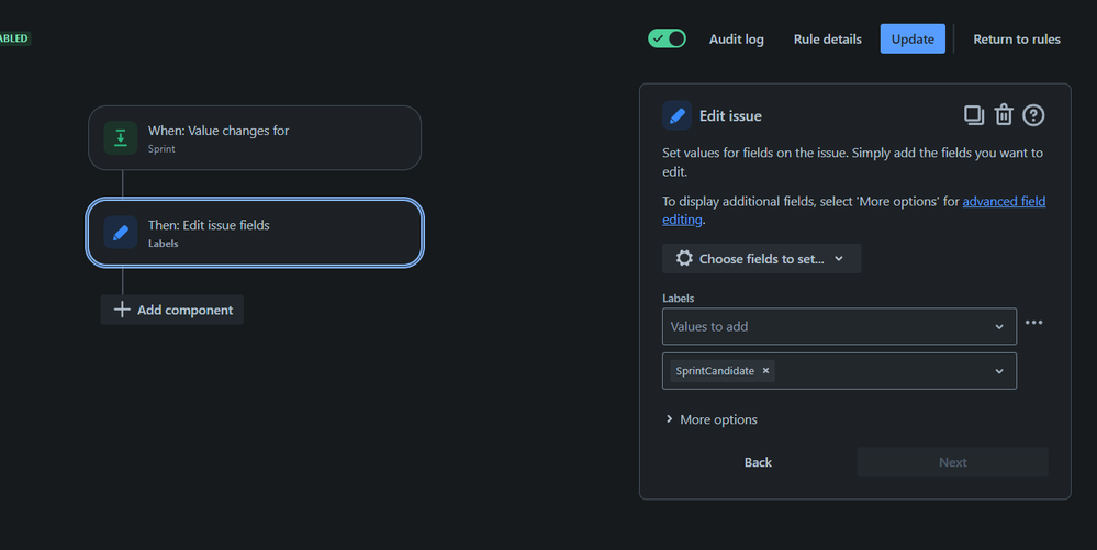

BenWade
April 16, 2024
So I created this simple rule and it works. It removes a spricifc label when value added to the 'Labels' field. I am curious if this rule can be improved. Maybe there is a better trigger or condition to replace the current one.
Bill Sheboy
April 16, 2024
Hi @BenWade
The rule seems to do what you ask (i.e., remove a specific label), triggered when you want it to run (i.e., when the sprint field changes).
What type of improvement are you considering?  Do you need to check for assignment to a specific sprint?
Kind regards,
Bill
