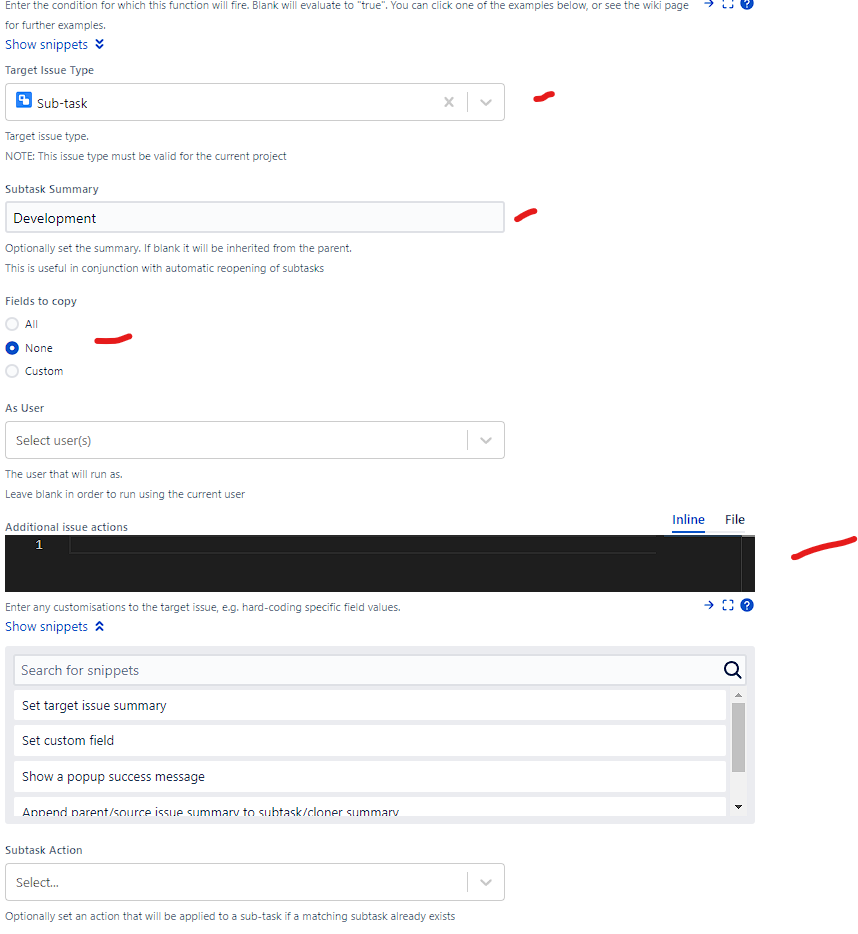

@Manoj Yes.  On the issue create transition in the workflow you will just need to add a post function and use the Create a sub-task [ScriptRunner] post function to add the sub-tasks.

@Brant Schroeder Thanks, i am at the same page, but writing script is challenge, as it's completely new to me, any guidance further from your end would help.
Brant Schroeder
March 2, 2023
@Manoj If you use the post function listed above the issue creation is very simple as majority of the settings would be done through the GUI.   If you would like to add additional information to the sub-task that can be done through additional issue actions and you can find snippets to help you.  You can also look at the documentation here: https://docs.adaptavist.com/sr4js/7.10.0/features/workflows/post-functions/built-in-post-functions/create-a-sub-task?utm_source=product-help

@Brant Schroeder Hello, GM, thanks alot for sharing your inputs on my request, i have tried above steps to execute, however this only create 1 sub-task at a time, but i want to have all 4 sub-task at one go. any suggestion pls.
Manoj
March 2, 2023
@Brant Schroeder I realized the error happened during performing this execution, its corrected and now it is working as expected.
