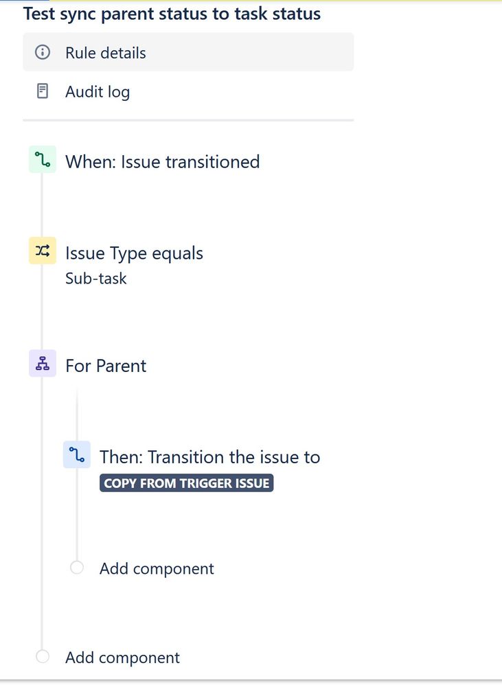

You are correct I do want to have the Parent task moved to In progress when the first subtask moves to In progress. The parent task stays in the In progress status until the last subtask moves to done at which point the parent task also moved to done.
Attached is what I made and it moves the parent to done when 1 of 3 subtasks are done.

The rule I made moves the parent to done when only 1 of 3 of the sub tasks are done.
I want the parent to stay in progress until all 3 sub tasks are done.

@PATRICIA MURPHY , yes as shown that is exactly what I would expect your rule would do, there is no condition checking if all subtasks are in Done. Can you review the new link I sent and video?

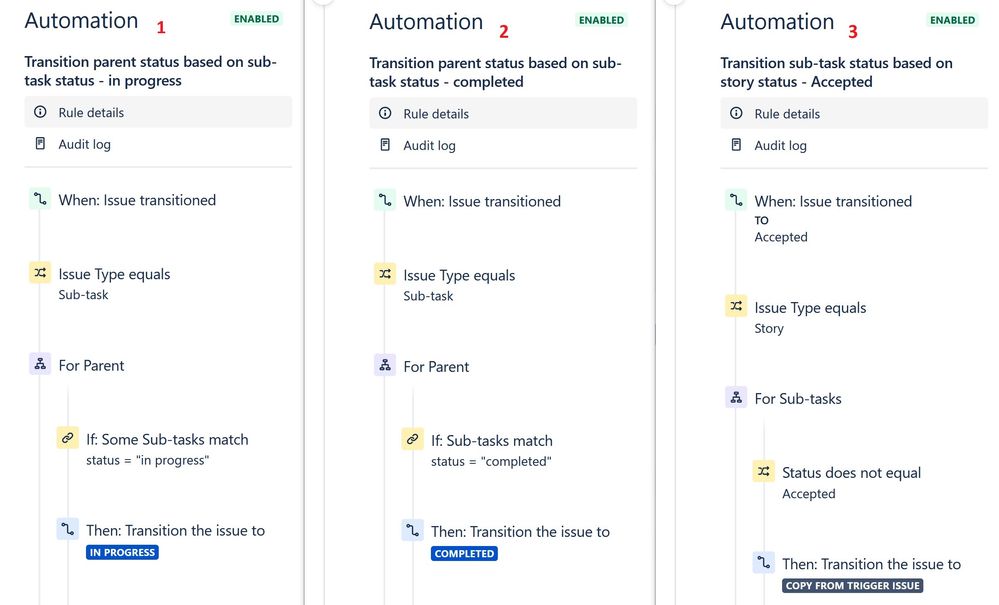

I created and enabled 3 rules in my project.
1. Update the parent status to in progress when any sub-task transitions to in-progress.
2. Update the parent to complete when all sub-tasks are complete.
3. Update all sub-tasks to Accepted when the parent "Story" is Accepted.
This seems to be working for my use cases.
