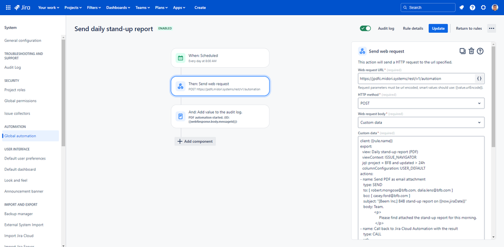

@sai armitha With the Better PDF Automation app, you can create a standard Jira Cloud automation rule with these components:
  1. Trigger: it is very likely that after the agent responds to the customer, the issue is transitioned to a status like "Waiting for customer", therefore use the "Issue transitioned" trigger to start the automation rule.
  2. Action: use the "send pdf" automation to export the issue to PDF, attach it to an email and send to your preferred recipient (for example the customer in this case, but you can also CC/BCC it).
Here is the step-by-step guide how to create a rule that implements this notification mechanism. It is not complicated, your result will look something similar to this:
(Discl. this app is developed by our team.)
