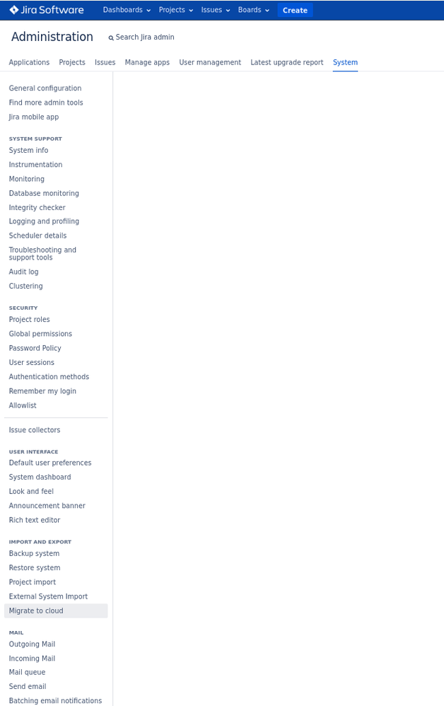

I'm trying to migrate to the cloud from a self-hosted server.
When I select "Migrate to cloud" the page is blank apart from the menus.
How can I procede?
Adam Rypel _MoroSystems_
February 12, 2024
Hi @Barrie Walker ,
there might be a problem with firewall allowance. Check your firewall configuration according to this documentation: https://confluence.atlassian.com/jirakb/preparing-your-firewall-to-migrate-using-the-jira-cloud-migration-assistant-1026058250.html
Also maybe try to check the network tab in developer console (F12 in your browser) to see, whether there are some calls going on when clicking on the Migrate to cloud tab.

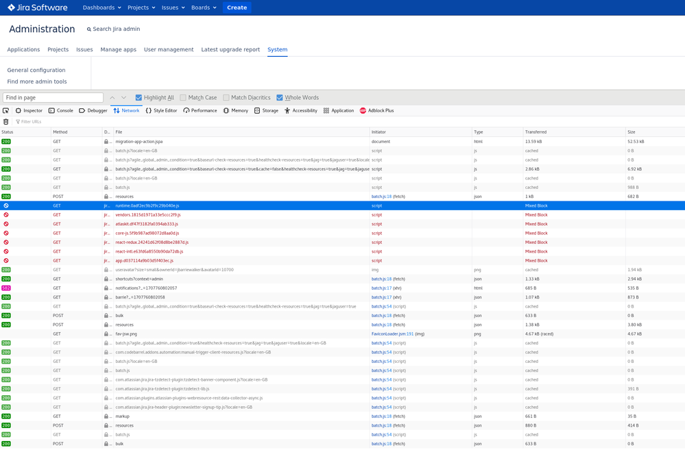

Barrie Walker
February 12, 2024
Hi @Adam Rypel _MoroSystems_ ,
Thanks so much for your reply.
I'm embarrassed to admit I'm not entirely sure what I'm to check wrt the firewall requirements. If it's the ip6tables firewall that's meant I'm pretty sure nothing necessary is blocked.
Using the developer console on the debugger tab I get
Paused on exception
Error: A response outside OK range (200-299)
at batch.js:26
On the network tab there are certainly things that look wrong but they all look internal.
