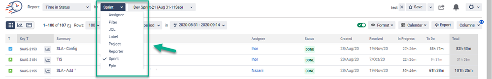

Hello @Rob Horan
If it's ok for you to try the third-party add-on - Time in Status for Jira Cloud can help to solve your issue. This add-on is more suitable for tracking time in statuses and analyzing team efficiency.
It also includes a very user-friendly epic search. So you can track the total time spent on each issue (filtered by the Epic you need) in the "Total" column
This add-on is developed by my team and is free for use for teams up to 10 users. Please, let me know if you have any questions.
Hope you find it helpful.

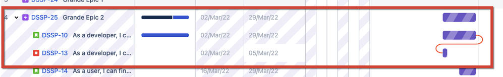

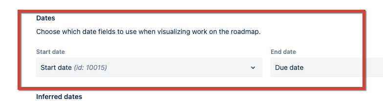

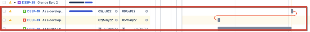

@Walter Buggenhout  I tried to do so in a test, and its not working at all.
My start and end dates are configured correctly:dates.png
So then I set up two issues with a dependency. The issue that needs to finish first was set up to extend for the next few days.
When I auto-schedule, instead of adjusting the start and end dates of the second issue based on the end date of the first, the first one just got rescheduled to an earlier date.
Unless I'm doing something completely wrong?

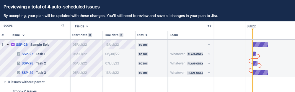

Rob Horan
July 5, 2022
@Walter Buggenhout  - I tried with a completely new epic and tasks, and auto-schedule is completely ignoring the dependencies.

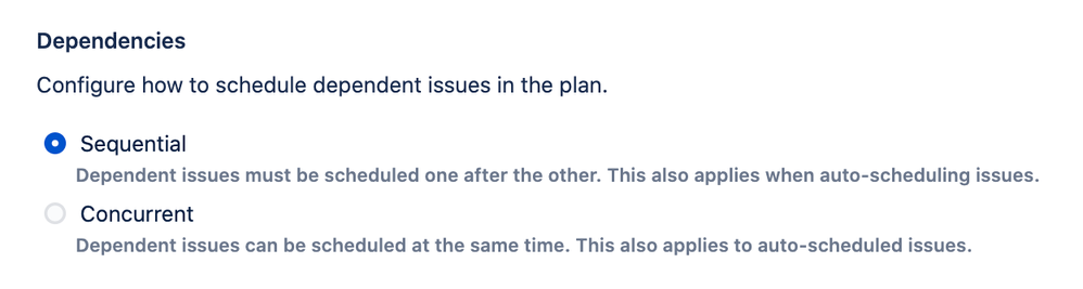

There's a lot to learn, @Rob Horan. As I said: there's quite a bit of complexity. Just below the section where you selected your start/end dates, you can impact the behaviour of your dependencies as well:
