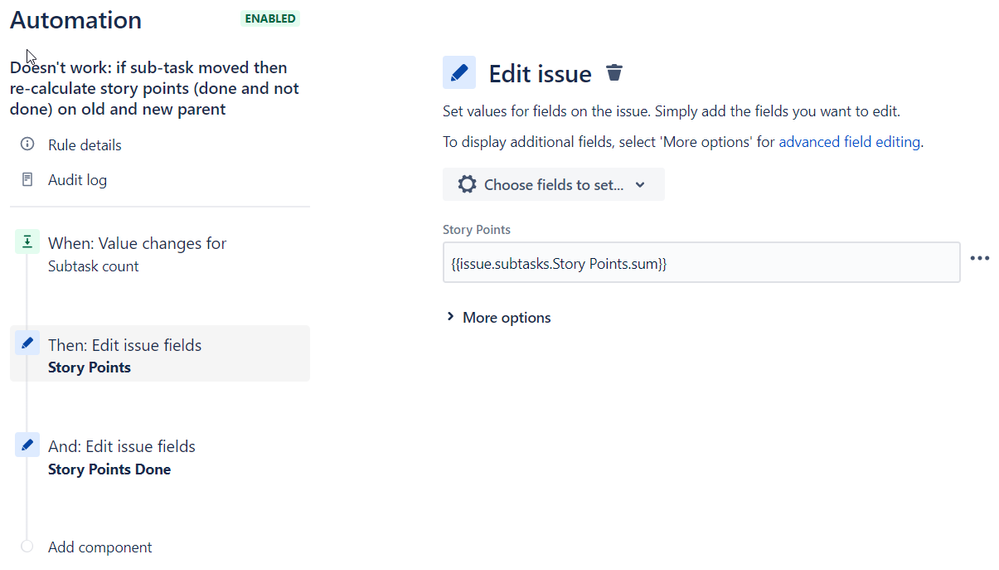

Hi @Bill Sheboy cc: @Alex Koxaras -Relational-
the rule based upon "Subtask count" is the following: According to my understanding, this should work for both parents

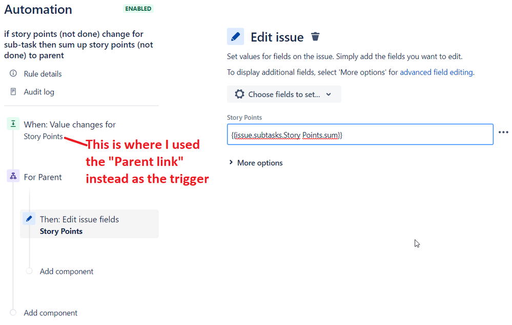

The rule base upon "Parent link" however I deleted already for it didn't work and I needed another rule for the old parent anyway. It was similar to the follwing rule but just using the "Parent link" field as its trigger:
Kind regards

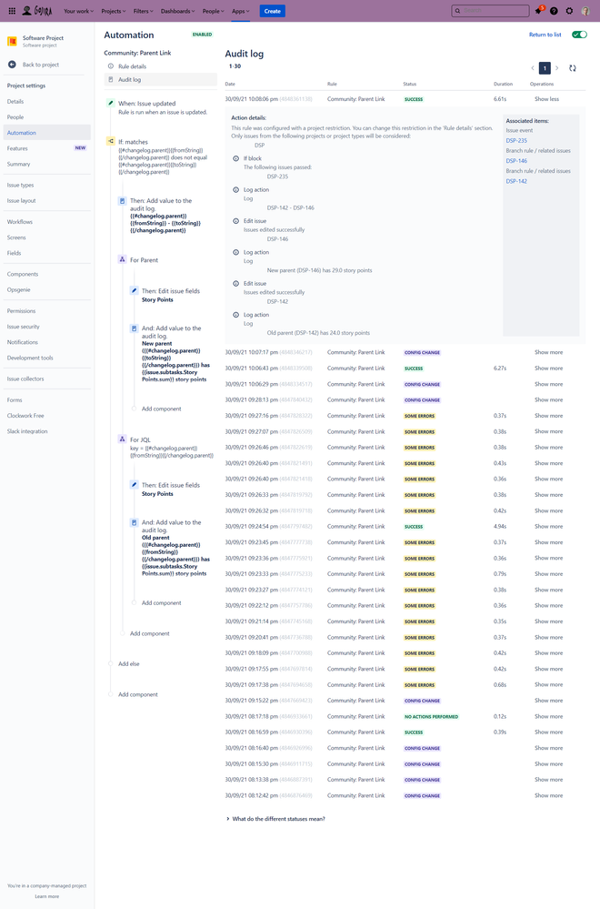

Wait up!!! I've done it! I just have to tuck my daughter to bed and I'll post the rule
@Bill Sheboy as always you were on the right track, with the exception that changelog works like a charm:
I wasn't able to post it earlier, since I had personal things to attend to :)
Thanks, Alex! I last tried that with changelog about a year ago...I think.
Did you test that rule with a move operation? How about with company-managed versus team-managed as they have different parent handling?
Yes I did move three times subtasks from one parent to another and works as it should be! I didn't try on TMP, since I find myself always playing in CMP. Perhaps I'll give it a go and see if I can come up with anything!
Awesome! And I believe that as you have implemented the rule with branches, it may also handle the case of issue type conversion/move: sub-task to story, or the other way around.
So far what I've implemented works only for when subtasks are moved to a standard issue type (only child-parent relationshp)
