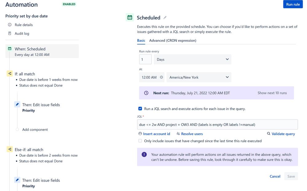

Thanks, Mark for the suggestion.  I'm not sure if your solution would work as I would want the priority auto-updated as a due date approaches?
Regardless, I did some more experimenting and I now realize that JQL field is for the initial search parameters that will run each time the automation is scheduled.  I had assumed that the if/else blocks would take care of this, but I guess you need a broad JQL search to kick off the process?
Anyhow, I put in "due <= 2w" in the JQL field and it seems to be happy with that.  (Even though this is basically repeated in the if/else blocks???)

Thanks for the additional context.  If you want to share a screenshot of your rule, we can help optimize it.  The query should only be required once at the trigger.  I would have something like this:
  • TRIGGER: duedate <= 2w AND resolved is not empty
  • IF CONDITION: Priority = High
    • ACTION: Do something
  • ELSE: Priority = Medium
    • ACTION: Do something else

The idea is to set priority to "highest" <1wk out, and "high" <2wk out.  I've created a label ("manual") to allow people to exempt projects from this automation.
Mark Segall
July 20, 2022
A minor tweak is that you could add this to your trigger query and remove from your conditions.  It'll perform a little better, but otherwise, your rule looks good.
AND status != Done
