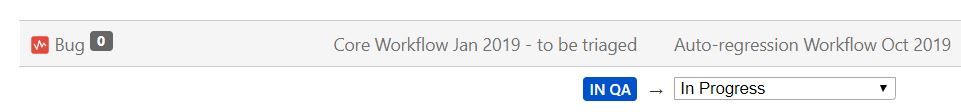

I am attempting to associate a new workflow, "Auto-regression workflow Oct 2019" to an existing project.  After clicking publish (I am assuming "publish" is the same as " Associate" in instruction snippet above) I am presented with this:
bugStatus.JPGIf I change the status of the Bug Issue from "In QA" to "In Progress" to be compatible with the "Auto-regression workflow Oct 2019" workflow, will this be a global change of the status effecting all instances of the Bug issue in all the projects it appears in, or will it just be local to the new workflow?

Hi @David W ,the small number right beneath the issuetype ("Bug" in your screenshot) shows the number of issues of this type in your project.
If this value is "0" you can ignore the change. The status will be changed from "In QA" to "In Progress" for 0 issues, so you don't have to set anything.
Only if the number is > 0, you have to set a new status.
The status will be changed in all the projects which are using the changed workflow. This can be a single project but if the workflow is shared between several projects, the status will be changed in all these projects.

When presented with options like the one in the screen shot two things are going on:
  • I am being asked to reset the status values on a specific instance of a bug with in the project (in this case there aren't any) so it is compatible with the new workflow.
  • I am changing the the status values associated with the bug issue type so that the status values that can be set for all future bugs will be compatible with the new workflow.  For example, if I make the change specified in the screen shot, when I set the status of a new bug I won't have the option to set it to "in QA", but I will be able to set it "In Progress".  Any changes to the status associated to an issue type are local, and specific to that workflow.   They will only be applicable to the projects that use it.

Yes, that's true, "In QA" is not available anymore, because it's not part of the workflow anymore.
The number "0" means, that there are no issues of this type currently impacted by the workflow change.
