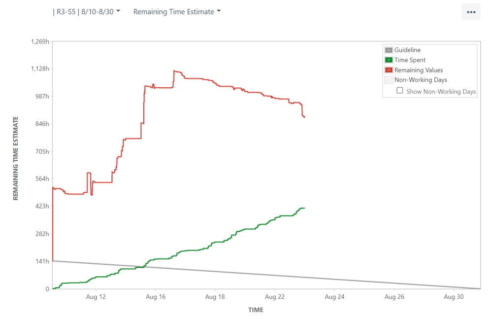

Adam Hanson
August 22, 2022
Thanks. What would be the best way to not see unused time for completed tasks in a burndown chart then?Screenshot 2022-08-22 190547.png
Nic Brough -Adaptavist-
August 22, 2022
Nothing.
Burndown measures what you saiid you would do against what you did.  There's no looking at partial completions.
