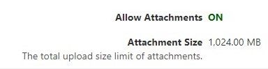

users are trying to attached a 7+MB spreadsheet to an Issue within our Cloud based Jira instance, but it fails to complete the attaching process ?
Here are our Jira system settings, so that spreadsheet should attach as far as I understand.
Any suggestions on what else to check & why ?

Dear Matthew,
do you get an error message from the application or from the browser when uploading the file?
Could you provide a screenshot, please?

Investigating further, I can attach the file to the Issue but my users cannot - one is based in the USA and one in the UK.  And I'm an admin and they are not.  Once I've attached the file, my users can then see what I've attached & download it.
So I'm confused at the moment and looking for suggestions as to what next..
