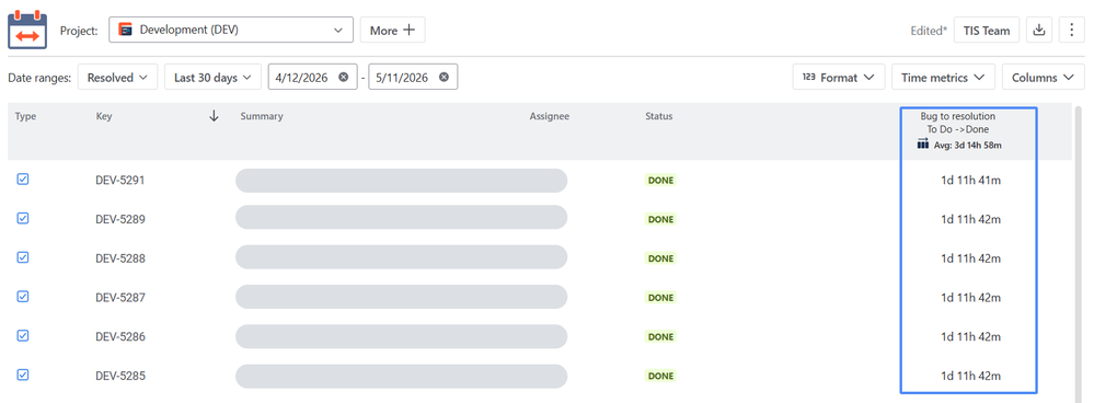

Time in Status Reports
With this app you generate time in each workflow status for multiple issues with multiple filter and grouping options. It works for current issues and closed ones as well.
With Status grouping feature, can help you define your own cycle time / issue age time and view the averages of the same. You can add your specific statuses to the status group to calculate the bug age. Also the app has 20+ reports to meet a variety of use cases.
You can set your own working calendar to exclude weekends and holidays from the time in status calculation.
More details here.

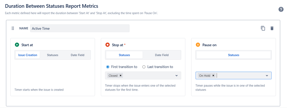

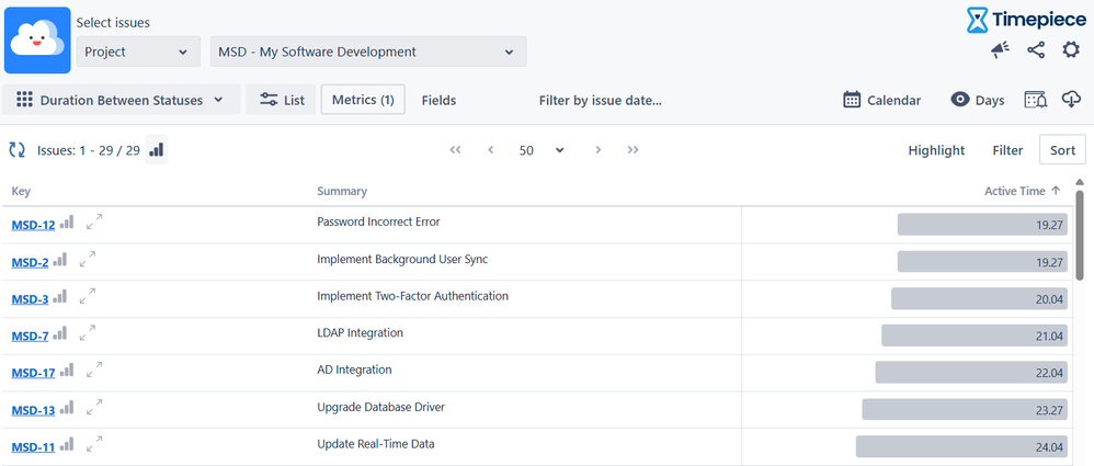

If you are open to using a Marketplace app, you can easily achieve this exact use case without any complex automation rules by using the Duration Between Statuses report in Timepiece - Time in Status for Jira.
Here is exactly how to set it up:
Select the Duration Between Statuses report type and click the Metrics button to define a custom metric.
Set Start At to "Issue Creation" and Stop At to your completion status.
Set the Paused On option to your "On Hold" status.
With this setup, the metric will automatically pause counting whenever the bug enters the "On Hold" status and resume when it moves to another status, giving you the precise total active resolution time excluding the hold duration.
Pro tip: You can also apply Timepiece's Custom Calendars to this report to automatically exclude weekends, nights, and public holidays from your total resolution time. And with Timepiece Assistant, you can ask AI to configure any report for you.

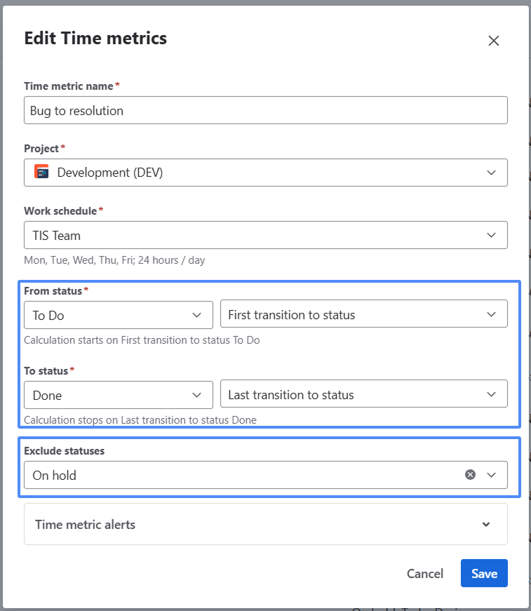

For this use case, the best approach would be to use Time Metric Tracker instead of trying to calculate it manually with smart values in Jira Automation.
You can create the required metric, for your example - Bug Resolution Time, and configure it to calculate the time from issue creation until completion/resolution. In the metric settings, simply exclude the “On Hold” status.
After that, the app will automatically calculate the total active time while ignoring the time the issue spent in On Hold. So the timer will effectively pause when the issue is moved to On Hold and resume when it moves to another status.
This should give you the correct resolution time, excluding the On Hold duration.
You can also try the free trial version of the app to check whether it fully covers your use case.

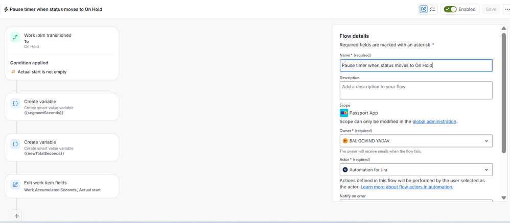

BAL GOVIND YADAV
May 14, 2026
Thanks for the update!

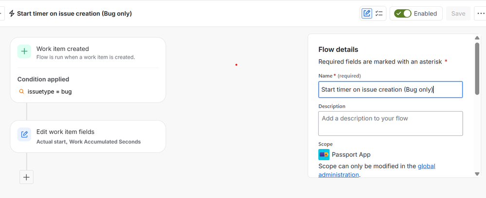

here are the snaps attached:
Automations rule 1:
set Actual Start : {{now}}
Work Accumulated seconds: 0
Automations rule 2:
Work item transitioned to ON HOLD
Condition applied: Actual Start is not empty
create variable:
segmentSeconds: {{now.diff(issue.customfield_10008).seconds}}
newTotalSeconds: {{#=}} {{issue.customfield_10433}} + {{segmentSeconds}} {{/}}
edit work items :
Work Accumulated seconds:{{newTotalSeconds}}
Actual start: 0

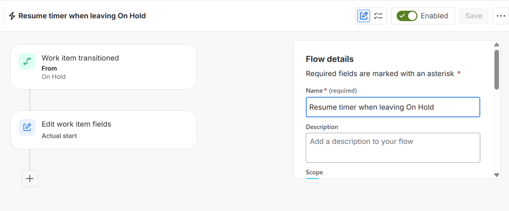

Automations rule 3:
Work item transitioned from ON HOLD
edit work item fields:
Actual start: {{now}}
Automations rule 4:
work item transition to Done
create variable:
finalTotalSeconds: {{#if(issue.customfield_10008)}} {{#=}} {{issue.customfield_10433.asNumber}} + {{now.diff(issue.customfield_10008).seconds}} {{/}} {{else}} {{issue.customfield_10433.asNumber}} {{/}}
edit work item:
Work Accumulated Seconds: {{finalTotalSeconds.asNumber}}
Actual end: {{now}}
Actual start: 0
create variable:
days: {{#=}} floor(finalTotalSeconds.asNumber / 86400) {{/}}
remainingAfterDays: {{#=}} finalTotalSeconds.asNumber - (days.asNumber * 86400) {{/}}
hours: {{#=}} floor(remAfterDays.asNumber / 3600) {{/}}
remainingAfterHours: {{#=}} remAfterDays.asNumber - (hours.asNumber * 3600) {{/}}
minutes: {{#=}} floor(remAfterHours.asNumber / 60) {{/}}
edit work item:
Total Resolution Time: {{#if(days.asNumber.gt(0))}}{{days}}d {{/}}{{hours}}h {{minutes}}m
I need the total time when issue is on in progress if the issue is kept on HOLD it should stop calculating time when it is ON HOLD and resume when moved to other status and needs to display total time excluding that on hold duration time.

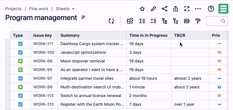

Aside from that, if you're open to solutions from the Atlassian Marketplace, the app my team and I are working on, JXL for Jira, gives you this without the automation gymnastics. JXL has a configurable Time in status smart column: pick the statuses to include (e.g. all except On Hold), pick an occurrence mode (sum of all visits), optionally apply a work calendar, and the active time shows up per row.
Disclosure: I work on the team behind JXL.
