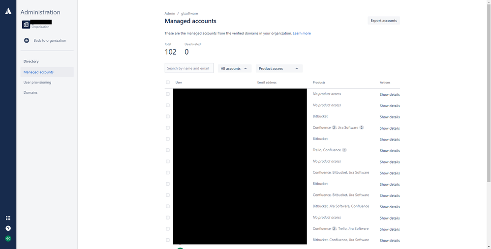

This article is gold! I just wished that I found it sooner. 1 question. I'm testing this for my org and I would like to know how can I isolate this for my self temporarily without importing my whole org? During the setup process, it looks like all of my managed accounts got imported.

@LocalAdmin I'm not sure if this has anything to do with it. But what I'm referring to is this. During my domain DNS verification process, I had imported a bunch of accounts here. Thinking it associated these cloud accounts with my AAD cloud accounts.

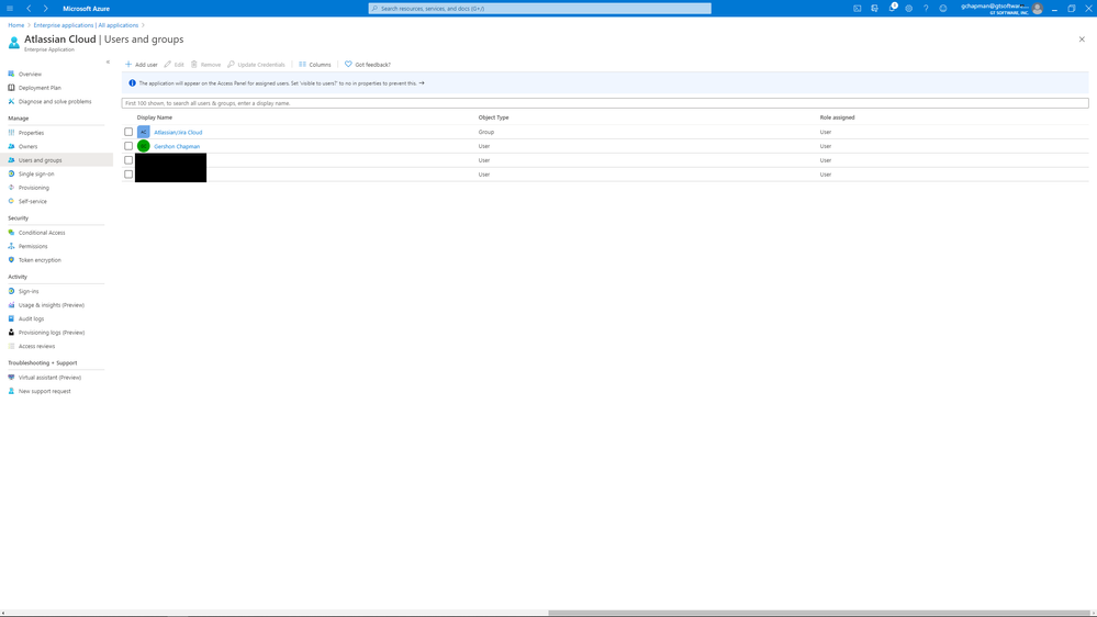

When I added the appropriate URLs in the Atlassian Cloud app to flip on SSO. I also added myself to the users and groups thinking I'd be the only person to use and test it for now before I added the rest of my users. That wasn't the case this AM when I had another user report to me that they weren't able to login with their Atlassian cloud creds. I had to add them as well as they were being presented with an error that they didn't have the appropriate role.
