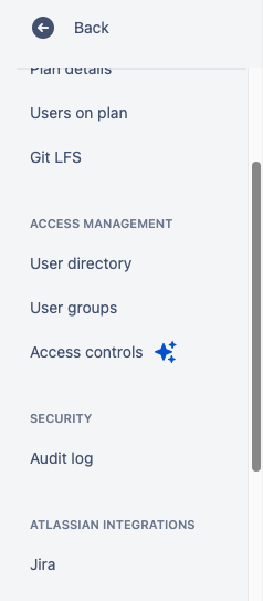

Are you an admin for the Bitbucket instance or for that repo? When you're in the workspace in Bitbucket do you see the Settings option in the navigation pane?
If not, what do you see?
If you do see Settings within your Workspace, when you click on it you should get a new navigation pane/screen and the navigation pane should include.
If you don't see that (assuming you did have a Settings option) can you attach a screen image to show us what you do see?

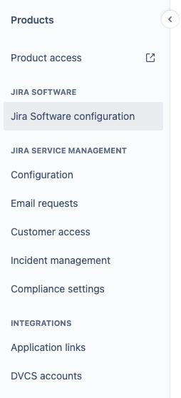

On the Jira side, click on the gear icon near your avatar and select Products. You should get a new navigation pane/screen that shows options like this:
The navigation pane should include an Integrations section with "Application Links" and "DVCS accounts". If you click on "DVCS accounts", do you see any Bitbucket workspaces and repos? Can you attach an image of what you see?

I see. Under BitBucket/Project, I have the integrations set to point to the proper Jira workspace.
In Jira, under DVCS Accounts, the correct projects in BitBucket are listed.
