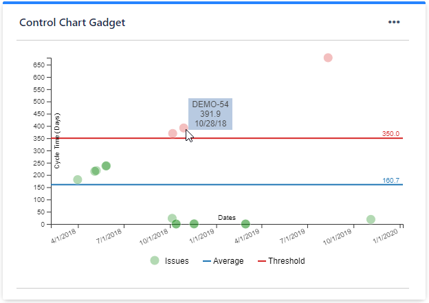

Danut M _StonikByte_
Atlassian Partner
January 12, 2020
Hi Al,
You could also try our app Great Gadgets for Jira Server or Great Gadgets for Jira Cloud.
One of the 10 dashboard gadgets included is the Control Chart gadget, which is based on a Jira filter and is fully customizable.
See https://bitbucket.org/StonikByte/great-gadgets-add-on/wiki/Home#!control-chart-gadget
