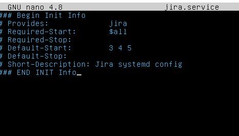

Ralf Thmas
October 18, 2021
Hello,
i created that file jira.system but it is not working
Greets
Ralf

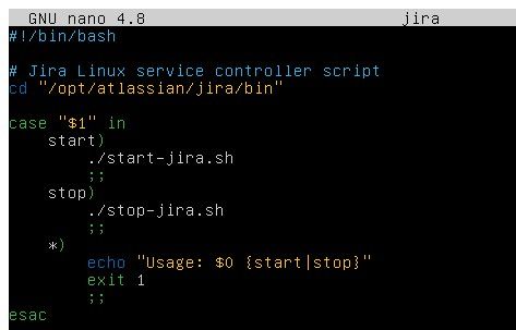

Ralf Thmas
October 18, 2021
in etc/init.d we have already an jira file i see. With that content
