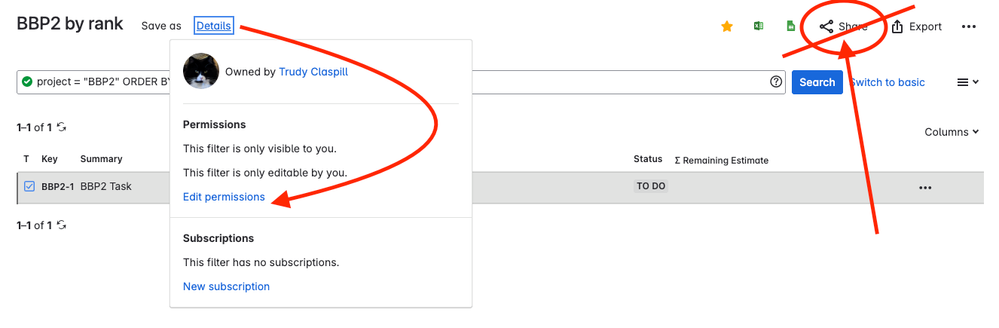

As @Marc -Devoteam- mentioned, if any of the gadgets are using Filters, then those filters need to be Shared with the related Projects; either for all Roles in the project or at least the "customer" role. That sharing is set up in the Filter Details, under Permissions, not by using the Share button in the upper right corner.

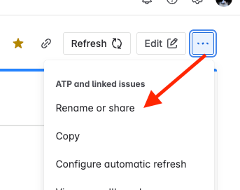

And you need to share the dashboard itself.
