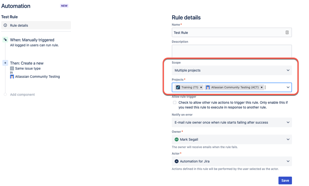

Without spending the extra money and avoiding several extra clicks to clone and move, automation would be the best route.  Here are some tips:
Project Scope - You want your rule to be set to multiple project and add both of your projects to the scope (see an example below)

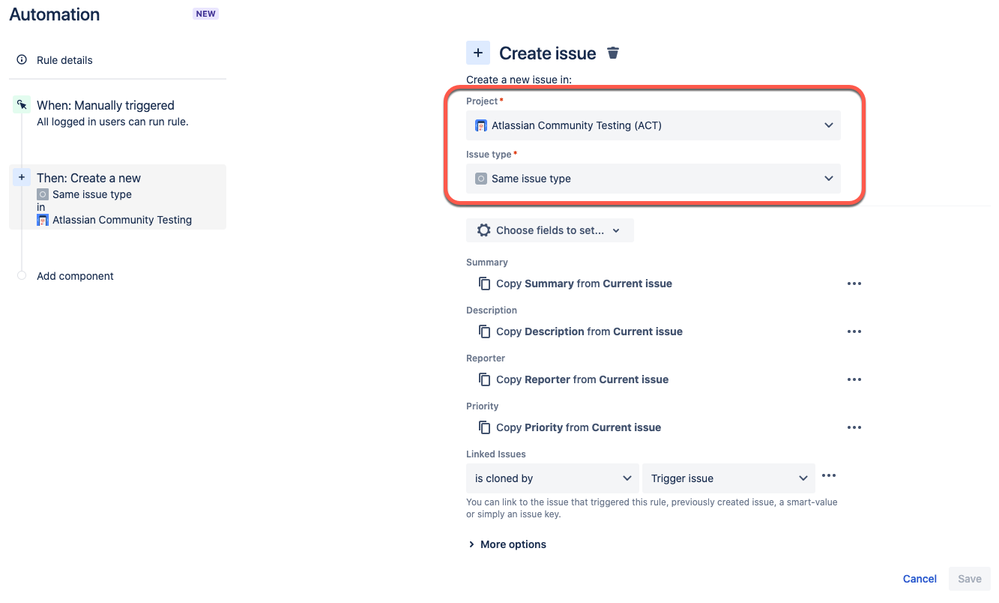

Rule - For simplicity, here's what I recommend:
  • TRIGGER:  Manually Triggered
  • ACTION: Create Issue - Select all of the fields you would like to have copied over.  For each you'll set them to copy from current issue
Here's an example (note the red box is critical:

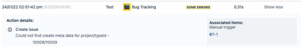

@Mark Segall so I've now set up the rule just like your screenshots, and I get the following error when running the rule.
I did manage to get the rule to run by changing the issue type from "Same Issue Type" to "Bug", but I don't want it always as a bug - I would like it to be the same issue type in case there are feature requests in the future. I also made sure that both projects had the same exact issue type, and that still caused the same error.
The last thing I tried which resulted in the same error was changing the Issue Type to "Same issue type as trigger".
