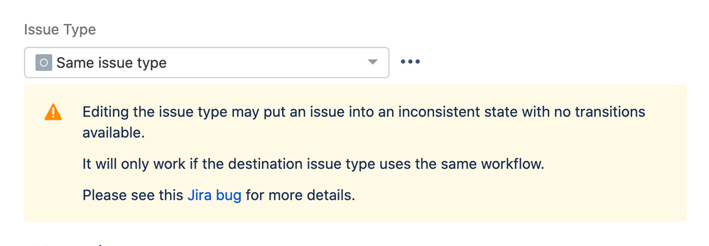

Moving an issue from one Issue Type to another is fought with danger and is one of the more complicated things inside of Jira. Changing issue type shouldn't be considered part of a normal workflow. We put a big warning up to help people understand this may cause issues:
What may work better for you is to create a new issue in the other board and link the 2 issues together. Would that work for you?
