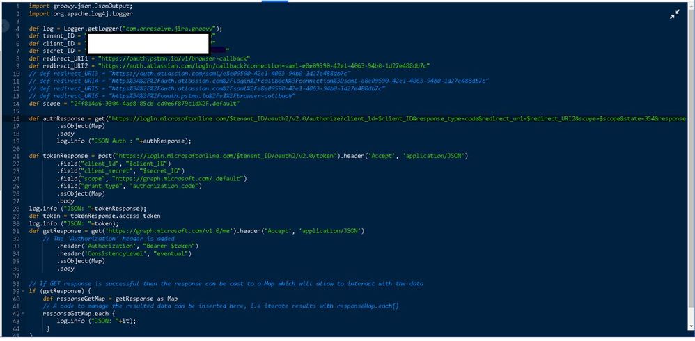

Hi guys,
We are using Scriptrunner to get a valid authorization response from Azure AD. The response is needed to get the authorization code needed to successfully request an access token.

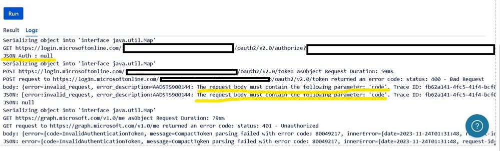

Below are screenshots showing the ScriptRunner script that we use and the response to the authorization request.
Note the JSON Auth: null response to the initial authorization request in lines 16-19. Due to the null response to the auth request, the subsequent request for an Access Token fails, with the message that the authorization ‘code’ parameter is missing.
