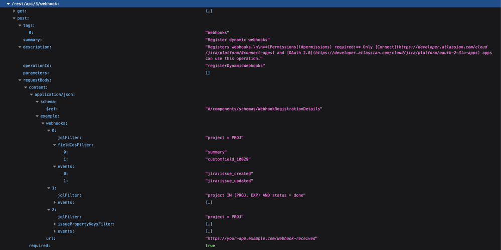

Hey @Andy Heinzer and @Dario B, sadly this didn't work as I hoped for. Getting an error back that says the "filters" field is unrecognized:
"errorMessages":["Unrecognized field \"filters\" (Class com.atlassian.jira.rest.v2.webhook.DynamicWebhookRegistrationConfiguration), not marked as ignorable\n at [Source: org.apache.catalina.connector.CoyoteInputStream@51879649; line: 1, column: 262] (through reference chain: com.atlassian.jira.rest.v2.webhook.DynamicWebhookRegistrationConfiguration[\"filters\"])"]
Initially I thought this was related to the API v2 which I'm using, but switching to v3 or latest (e.g. /rest/api/latest/webhook) returned the same error.
Also looking at the open API schema (https://developer.atlassian.com/cloud/jira/platform/swagger-v3.v3.json), I can't find any "filters", it's in fact "jqlFilter":
