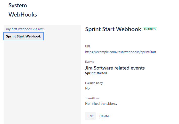

gouris
September 25, 2022
I am not using automation rule but using webhook.  it looks as follows
When the webhook gets triggered automatically (when sprint starts) where will I get the data it sends?

Stefan Salzl
September 27, 2022
Hi @gouris ,
all the information (JSON) of your created webhook will be sent to the URL defined in the "URL" field of your webhook. So as I got your requirement right this would be the api of your destination ticket system.

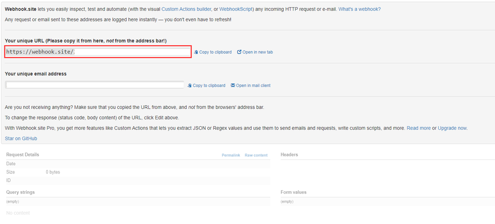

Stefan Salzl
September 28, 2022
@gouris
Your webhook needs to be configured to call the URL provided by the test tool.
Could you show your webhook config again?
personally i tested with https://webhook.site
When opening the site it provides you with a listener url (see screenshot) that needs to be filled in the url field of your webhook:
