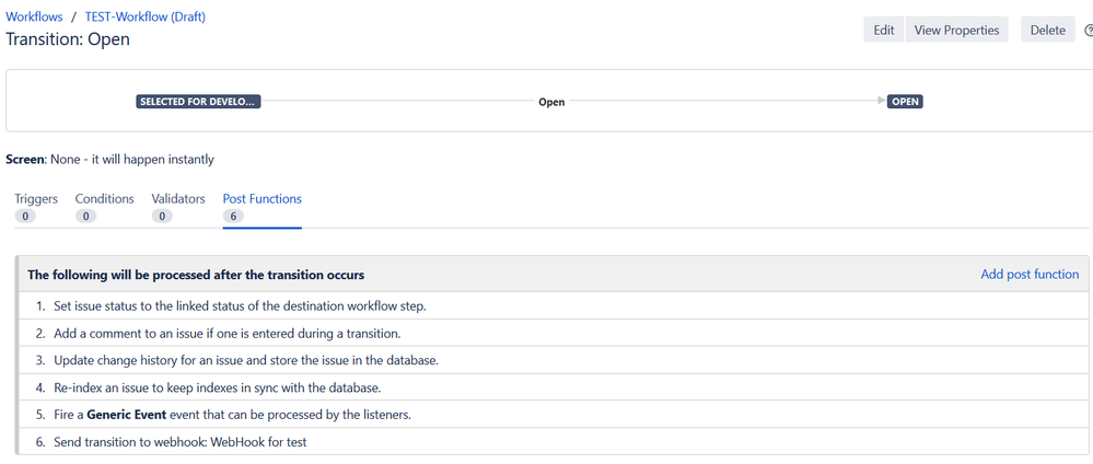

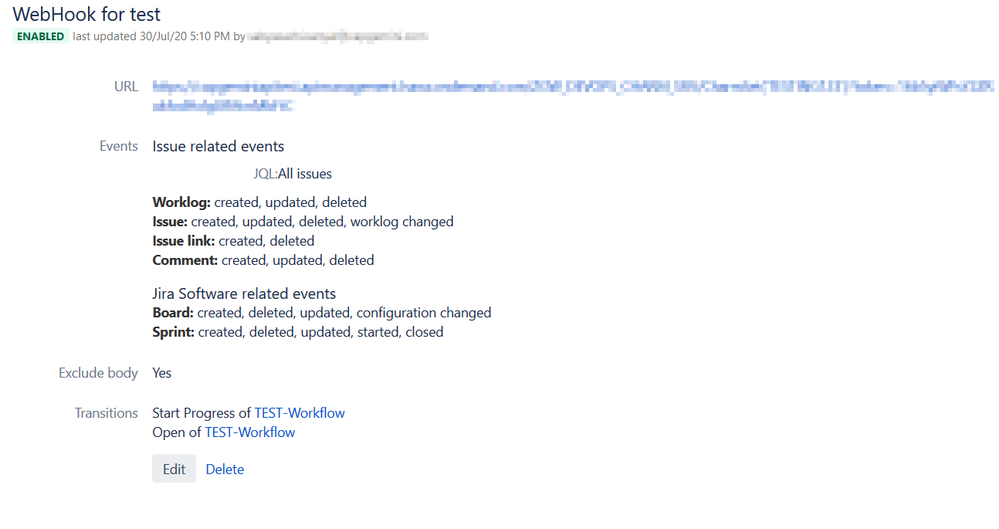

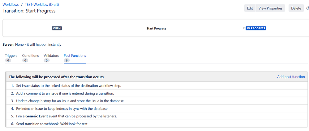

webHook - JIRA.pngTransition_ Open - JIRA.pngTransition_ Start Progress - JIRA.png
Andy Heinzer
July 30, 2020
I don't see a clear problem from the screenshots you posted. Did you publish the workflow after you made these changes to the post functions?  If not, it would explain why this is not behaving as expected.  Screenshots appear to be cropped so I can't see the upper part of the page that would better indicate if this is still a draft workflow or an active workflow.

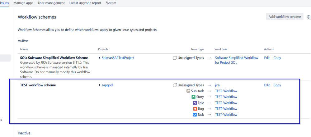

Saby
July 30, 2020
Hi Andy,

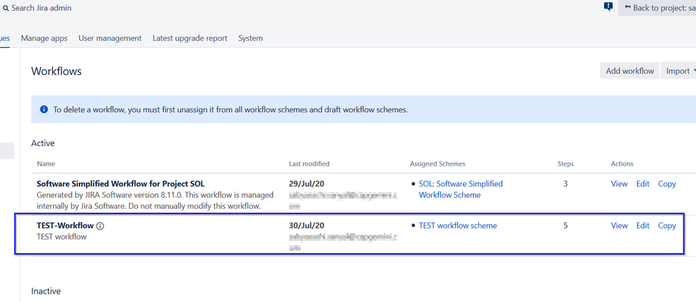

Yeap, the workflow is published after the post function addition in the transition and its active, missed the upper part earlier. Adding now.
Is there any way to dig further and check if the webhook is getting called successfully? I really cant see any in JIRA UI where a webhook calls are registered.
Regards
Sabyasachi

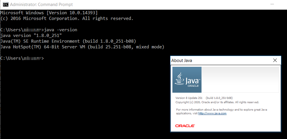

Am running on
1. JAVA 8
2. JIRA version Atlassian Jira Project Management Software (v8.11.0#811001-sha1:80088f0)
really not getting what could be the possible explanation here for the webhook not working. Would be great if you can help here.

I can't see exactly what the URL is that Jira is trying to use for the webhook, but it looks rather long and like it might contain one or more special characters.  If so, then you should be aware of this other bug JRASERVER-71214 : Webhook calls fail if destination URL contains special characters.
That bug ticket explains that some characters such as trying to generate a token from Azure systems might tend to use an equals sign '=', this character typically has to be encoded in order to be sent in the URI.  Some users have reported trying to generate different tokens/keys until they get one without any special characters as a work-around.  But that said, aside from the alphanumeric of A-Z, a-z, and 0-9 characters, can you let me know what other characters exist in the URL you have configured within Jira to use?
Have you tried to use an example site such as https://postb.in/ in order to generate a webhook URL and then try to see if Jira can send to that correctly?  It might be a good test to see if the problem is related to the URL you are using here or not.

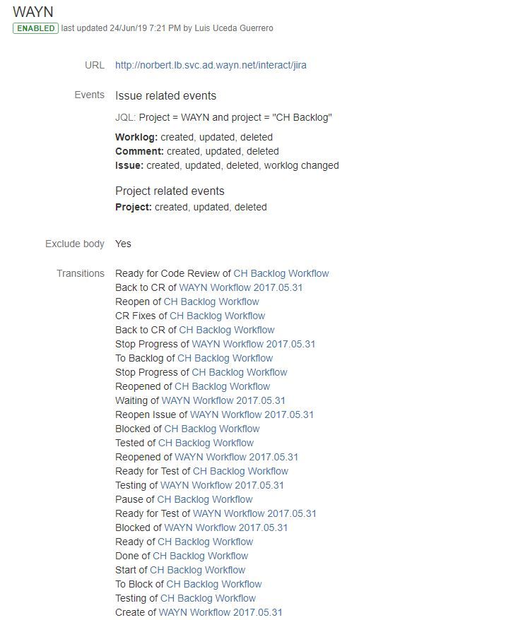

Hi Andrew,

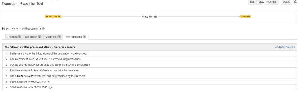

We also face same issue, I have reoredered the webhook in bottom of post function but still nothing is happening.
 1. JIRA Version : 7.1.0
Andy Heinzer
July 2, 2019
@Vasanta Kumaar I can see in your webhook you have a JQL filter of
Project=WAYN and project ="CH Backlog"
I can tell you that if these are two different projects, then your JQL query will always return 0 Jira issues.  In turn this could prevent this webhook from ever working.  That specific query is only return Jira issues that can match both projects.  Since no issue can actually be in more than one project at a time, there are no Jira issues that can possibly match both elements at the same time.
Instead if you only want match against issues in either project try a query such as
project in (WAYN,"CH Backlog")
Or perhaps remove the JQL entirely.  You can control which projects use the specific workflow so that method would probably be preferred here so that this webhook is only fired for projects that use this specific workflow in question.
I hope that helps.
Andy
Like Vasanta Kumaar likes this
Vasanta Kumaar
July 3, 2019
Hi Andrew,
Thanks a lot, Its working.
