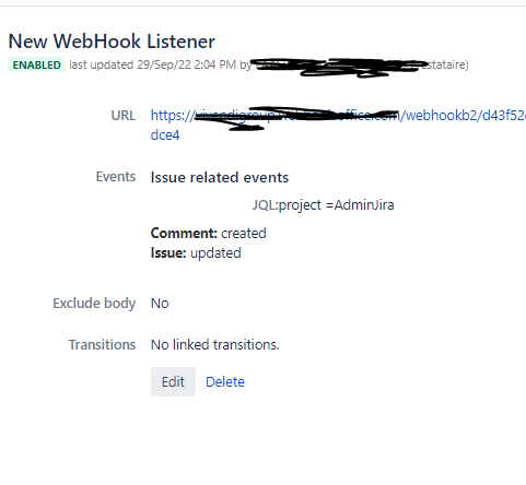

Hello the community,
We have a problem that block us, we configured some webhooks that triggered if an event Ticket updated or created ....
But the notifications not sending to Ms teams channel, we don't receive anything.
After a discussion with atlassian support they confirm that jira side all is good we have an error on the Ms teams side but we don't know how to fix that.
Here is the error :
2022-09-30 13:00:12,949+0200 httpclient-callbacks:thread-1268 WARN anonymous     [c.a.webhooks.plugin.PublishTaskFactoryImpl$PublishTaskImpl] Client error - 400 when posting to web hook at 'https://xxxxxx.webhook.office.com/webhookb2/d43f52d4-2cd9-425a-863b-ea19bfb2f35e@bf5c5de1-6a54-4091-a72f-90e32801628c/IncomingWebhook/'
Can anyone please help us to resolve this or give us some advice.
Thanks in advance!

Oumaima Laasri
October 6, 2022
Hello Florian, thanks fro the advance I changed the URL shared.
The message that I shared I took it from the log Jira .
I didn't understand your proposition , because I use the webhook config
I don't undesrtand where I should use The post and the json header ?
Regards,
