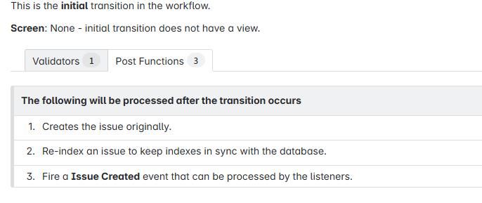

I spoke with my JIRA admin and he said POST was enabled in the workflow and provided this screenshot.
I will take a look at the webhook.site link you posted.
