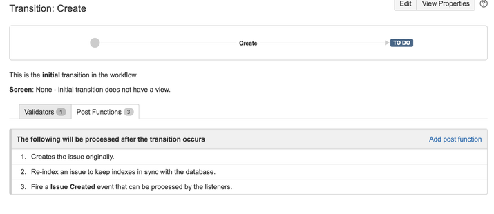

I'd be interested to see what your workflow looks like for the project where these issues are created.  Specifically, I'd want to take a close look at the create transition and see what postfunctions exists there and their order.
Your post functions for this should be specifically in the order below:
If you are missing any of these, or they are not in this specific order, it could be that Jira is triggering the webhook before the issue has been both created, and reindexed by Jira.  In either case, Jira would be unable to see that issue and provide the details on that issue into the webhook posted data.

Yes. The order of Post Functions means. Put the hook firing in the last. And it works. Thanks!
