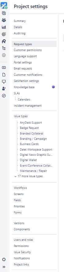

I don't find a menu item in my current permissions that is called "Issues".  I'll go to the Jira Admins here and share the information from you and Kai and see if elevated privileges will reveal those menu items.

That's the best thing to do here.  The settings in your screenshot are project settings usable by project admins.
If you have Jira admin rights, then you could follow the link "field" in that menu and it would eventually get to the place to create and maintain global custom fields, but if you do not, then you won't get the links to go there.
