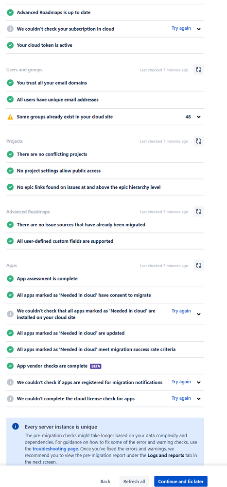

I'm trying to kick off another migration to JIRA Software in the cloud, from our local JIRA instance, but nothing happens??
At the pre-migration stage, I am see a number of unexpected messages eg:
"We couldn’t check your subscription in cloud" -- See fig1

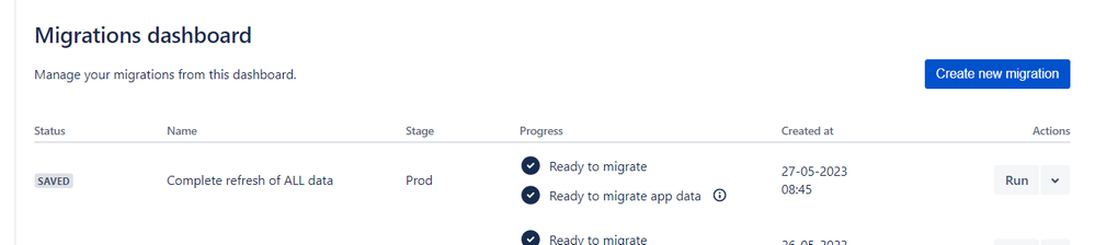

And when I click Continue and fix later, I see fig 2.

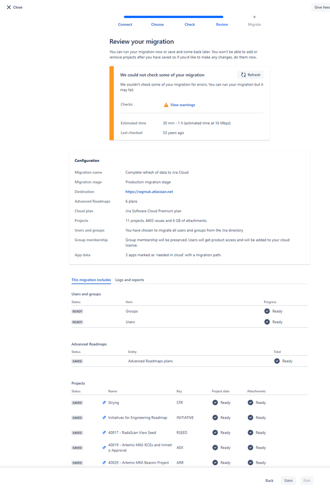

I click Save and see fig3 and clicking Run from the dropdown does nothing.
Why isn't the migration working??

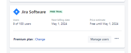

I THINK the answer is Yes to all three questions though the message implied that my subscription to the cloud product is not accessible?
Cloud subscription should still be active (even though it's a trial):

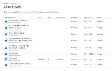

Having noticed that several of my apps were now inactive (and indeed not appearing in Billing), I reactivated them one by one viz:

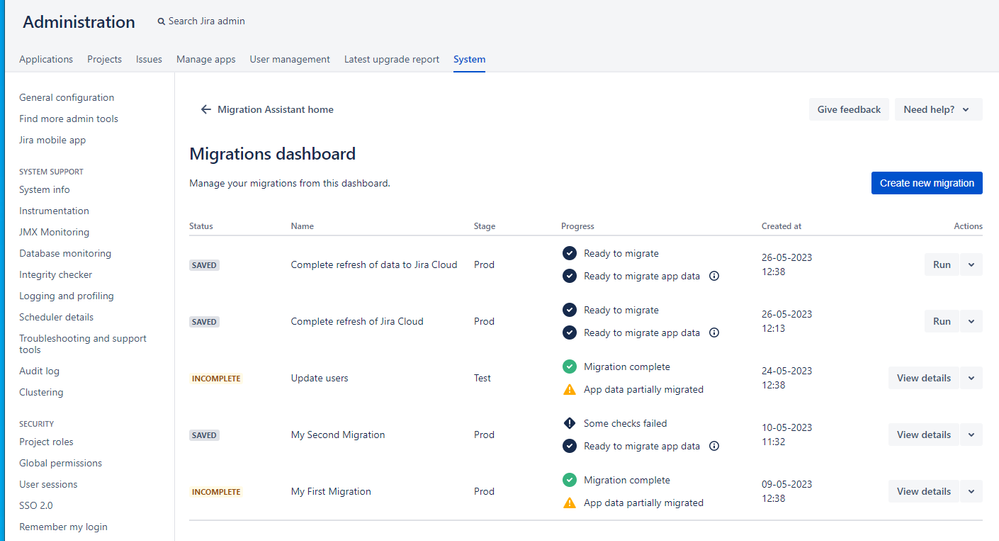

NOTE - Having deleted all projects, and reactivating all apps, I went through the migration wizard from our jira local, and the problem remains (clicking Run brings me back to the same state after a few seconds):
