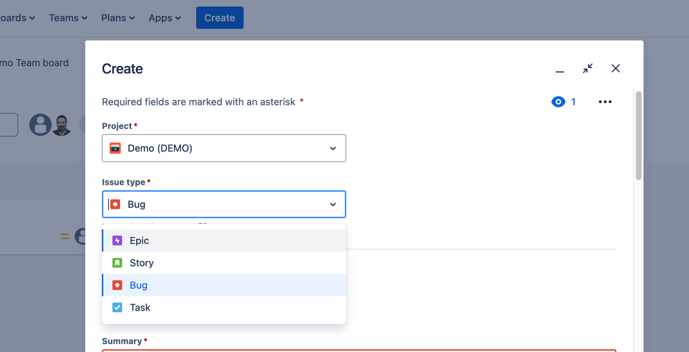

Hi @Nissim Ariel , please can share a screen of the project settings and one from inside the task where you are trying to create a subtask?
Thank you

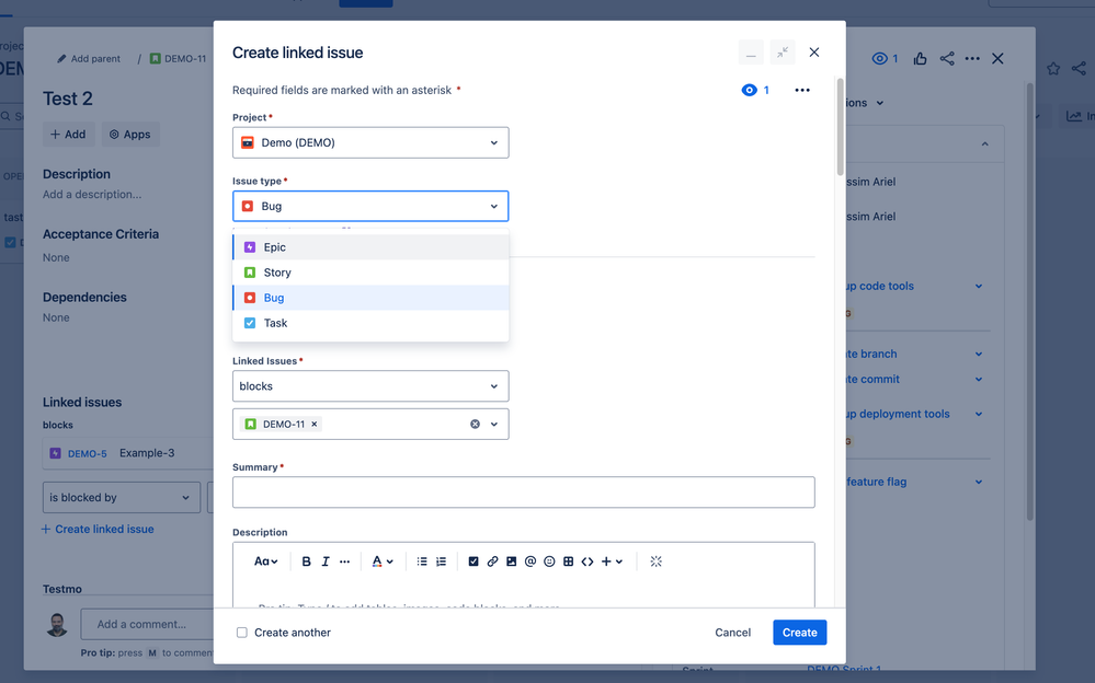

Nissim Ariel
January 5, 2025
Screen Shot 2025-01-05 at 17.22.05 PM.pngScreen Shot 2025-01-05 at 17.22.51 PM.png

@Nissim Ariel You have to create subtasks with the + Add button (top left) and not via the linked issues.
+ Create linked issue is only for creating other related issues in the same hierarchy or above.
Like Valerie Knapp likes this

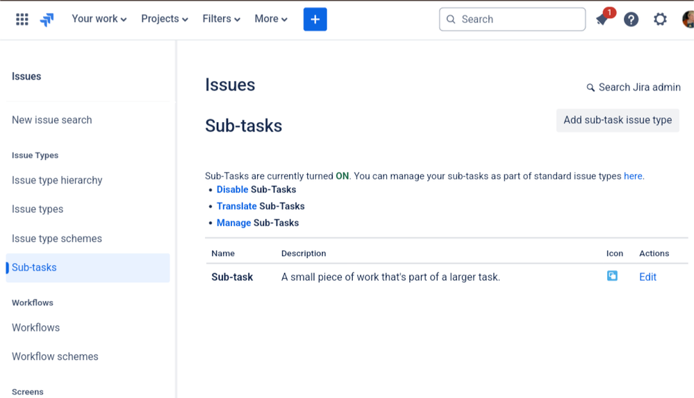

Hi @Nissim Ariel , please can you check the subtasks are switched on at the global level?
This is under the global settings, Issues, and then in the subtasks section.
Cheers
