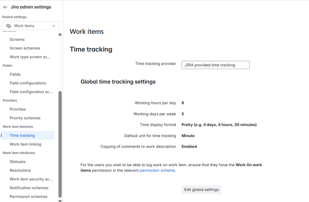

Hi @Ayşegül Yavuztürk ,
Try to check if time tracking is enabled. Go to Jira Settings → Work items → Time Tracking and ensure that it is correctly set for your instance. Also, you can check the users' permissions.
If a Time tracking field is not working in your project, you can go to Project Settings → Work items → Fields and make sure this field is added.

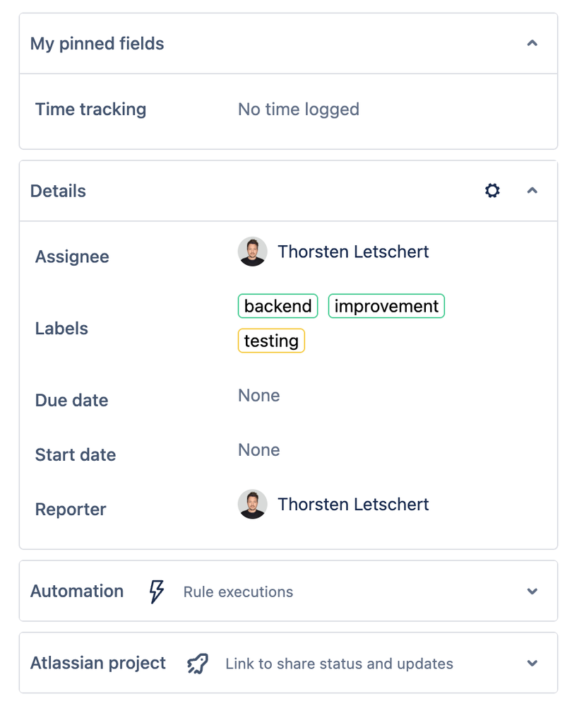

@Thorsten Letschert _Decadis AG_ I'm talking about logging time. Normally it was in the right corner for each task. Now it is not appearing.
If nothing has been changed configuration-wise, please check whether you might have unpinned the "Time Tracking" field by accident:
