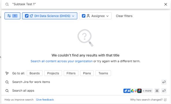

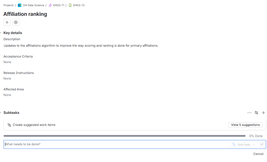

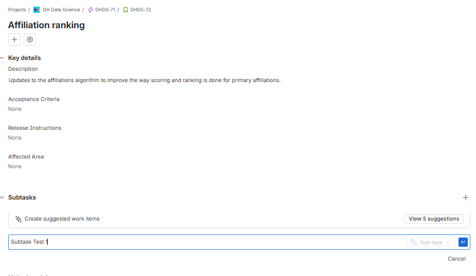

Here are some screenshots of what happens:
1. Creating a subtask
2. Click enter
3. The subtask is nowhere to be found

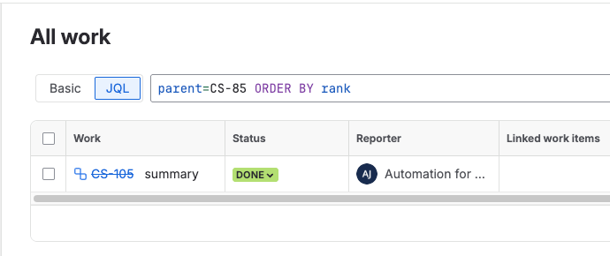

Hello @Kerry K

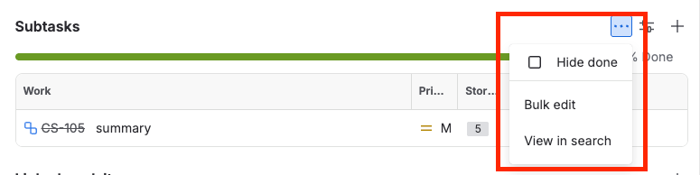

In the second picture there is a progress bar shown in the subtasks area, which indicates that the does have some number of subtasks.
Can you click on the ... button and select View In Search? Do you get a list of the subtasks associated with the issue?
Screenshot 2025-10-30 at 10.10.34 AM.pngScreenshot 2025-10-30 at 10.13.30 AM.png

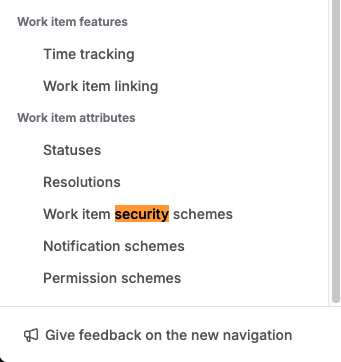

Can you check if a Security Scheme has been applied to this project? Navigate to the gear icon near your avatar and select Work Items.
Find the Work Items Security Schemes item in the navigation pane and click on it.

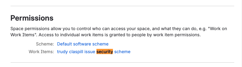

Check the resulting list to see if your space/project has been associated with a Security Scheme.
You should also be able to see that in the Summary page for the space/project settings.
Immediately after creating a subtask, have you check in the Global Automation page to see if any rules were triggered after the creation of the item? Perhaps execution of an automation rule caused the item to be moved or deleted or otherwise changed.
