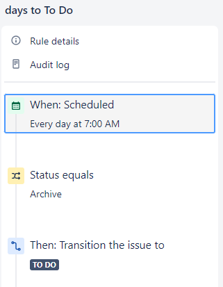

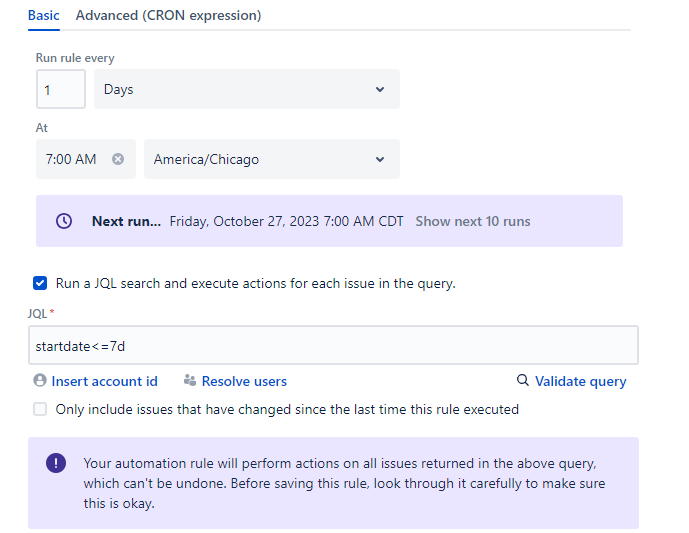

Here is what I have so far. Also tried - {{now.diff(issue.startdate).days}}<=7. Please advise.

Have you tried updating your JQL, to add the status condition, and remove the condition from the rule?  For example:
project = yourProjectName AND "Start date[Date]" <= startOfDay(7d) AND status = "Archive"
Then the rule will only run when there are issues to process.

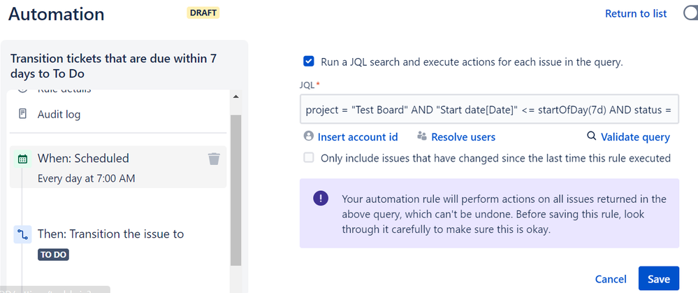

Followed your earlier suggestions on the query and removed the condition in the rule :
JQL Query - project = "Test" AND "Start date[Date]" <= startOfDay(7d) AND status = Archive
Ran the rule but the issue with a start date of 10/30 did not transition over to TO DO. There are no errors in the log.

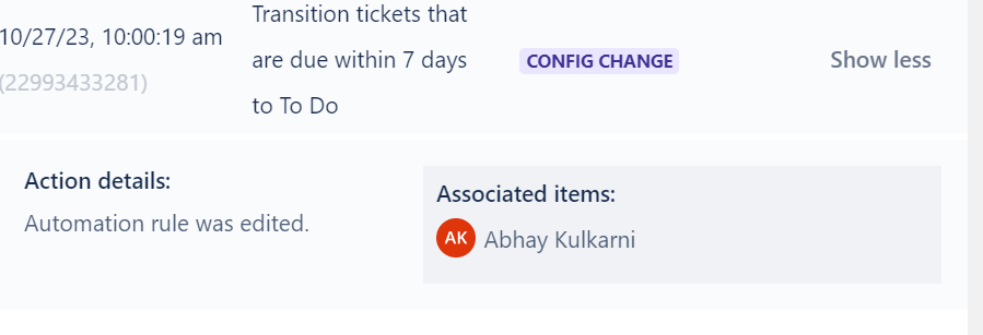

In the Audit logs, dont have a Failure or a Success Message, just the config change. I ran the rule within the Test Board -> Automations.

I do not see the rule run shown.
Did you select "Run rule" from the editor to force it to run now, rather than waiting for the schedule?
Abhay Kulkarni
October 27, 2023
Yes sir. I did.
Bill Sheboy
October 27, 2023
Then why does it not appear in the audit log for this rule?
Abhay Kulkarni
October 27, 2023
I had the rule disabled! My bad. Thank you for your help, Bill :)
