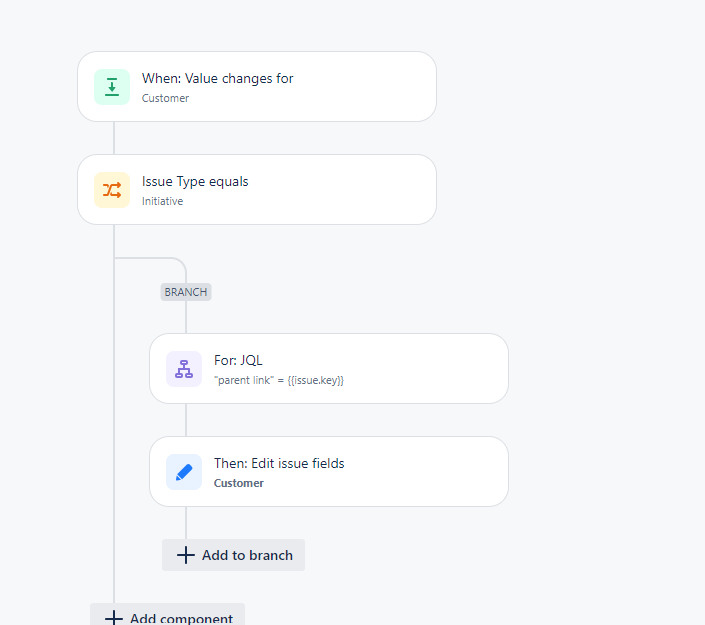

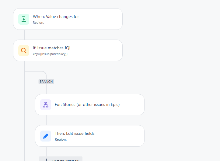

Arvind
December 12, 2023
Ben Finn
December 12, 2023

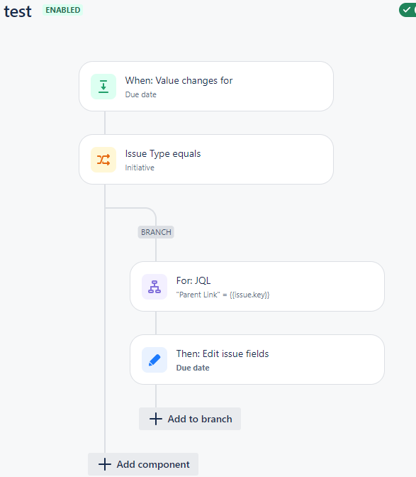

So the automation you have there is quite different the the one i recommended. Can you try this one and see if it works for you?
Notable differences:
- No need for the lookup, my JQL is just to ensure the change is an initiative issue type.
- Since the issue type is not epic, the For: Stories may encounter problems, so i recommend a simple For JQL and look for the parent key.
Here is a screenshot to help:
Like Arvind likes this
Arvind
December 12, 2023
Customer_JIRA.png@Ben Finn still not updating the Customer field in Epic level...

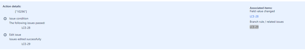

Two possibilities on the top of my mind. Can you show me the details of the "edit issue" component? Also can you show the audit log with its details expanded?

Audit Log:

The trigger is working and it is updating LCE-29, I assume this is the correct issue it's supposed to be updating. If so that means the only problem is it's not updating the right field or using the right data to update. Which means we've narrowed down the problem to that edit component.
If it's not supposed to be updating LCE-29, then we need to look at other components.
