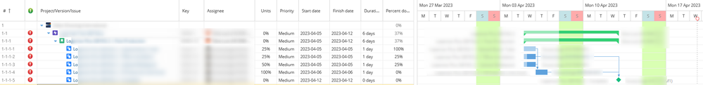

  1. When the epic and child issues are setup everything is ok:
    • Start Date is the same on Epic A and Story A;
    • End Date is the same on Epic A and Story C
    • Epic A Duration is the sum of all Story issues' Duration
    • Epic A Percent Done is e.g. 10% when there's some work on Sub-task 01 & 02; Story A's Percent Done is e.g. 50%.

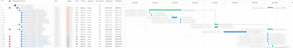

In this screenshot, I have the last Story (with sub-tasks) of the process and Epic is adjusting for those values.
This is what I see from the Project's Gantt chart:

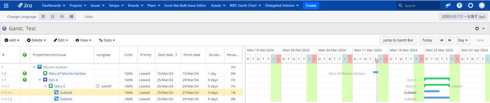

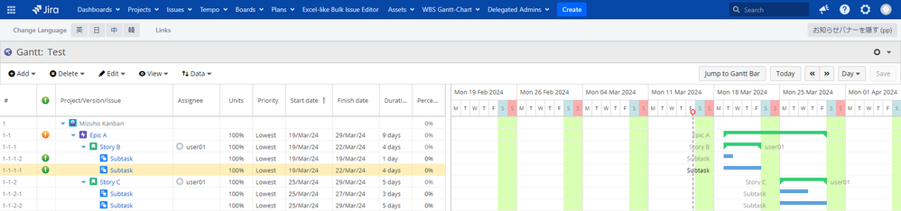

Since the Gantt auto calculates start/finish date and percent done from what's displayed.
It won't consider issues which are not on the screen.
For example, I created a filter like Luis;
project = PROJECT AND resolution = Unresolved
Then created a Gantt from the filter.
The Gantt only displays unresolved issue.
So as I resolve issues, less issues under Epic are considered to determine Epic's start/finish date.
After I closed StoryA, EpicA's start/finish date and percent done will be calculated based on StoryB and StoryC.
After I closed StoryB, EpicA's start/finish date and percent done will be calculated based on StoryC.
If you would like to Keep StoryA and StoryB's start/finish date and percent done, please modify your filter to display those issues.

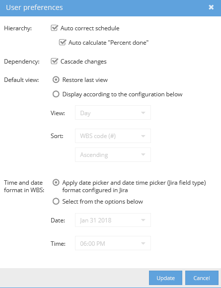

It would be better to enable Auto calculate Percent Done in your case.
https://docs.ricksoft-inc.com/wbs-gantt-chart-for-jira-data-center-and-server-0914/changing-settings
https://docs.ricksoft-inc.com/wbs-gantt-chart-for-jira-data-center-and-server-0914/updating-and-calculating-the-progress-rate-percent
The function can consider Epic (parent issues) 's percent done with child tickets' percent done.
Luis Silva
April 20, 2023
Hi @MINAMISAWA Hanayo[Ricksoft]
That's already enabled.

The values for Percent Done are set (see the first screenshot). The second screenshot is to illustrate the project's Gantt chart (same issue on Board and on Project).
