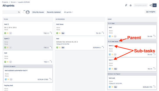

Per your description, I understand that you need your linked bugs to appear as a card below their stories on the board, just like you can do with Story and sub-tasks (As displayed in the screenshot below). Have I understood it properly?
If that's what you need, I'm afraid you can not do that using the default board of Jira software, as the swimlanes can not be configured based on linked issues. To achieve something similar, you can try one of the following approaches:

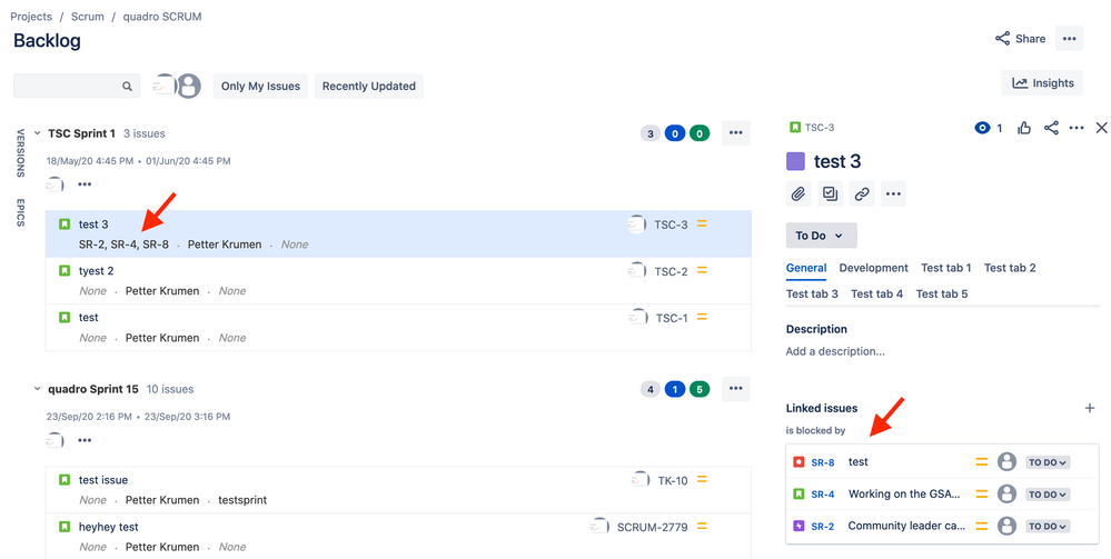

1 - You can properly display linked issues in the card layout of your board (configure it under board settings > Card layout). They will appear on both the Active Sprint and backlog views, however, they will not display its current status or any other details of the linked issues unless you click on the "parent issue" and open the issue detail view, as you can see in the screenshot below:

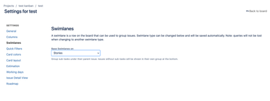

If that's what you are looking for, you can configure a swimlane in your company-managed board to achieve your goal. These would be the steps:
  1. Navigate to your board > Board settings > Swimlanes
  2. Select your swimlanes to be based on "Stories", as in the screenshot below:

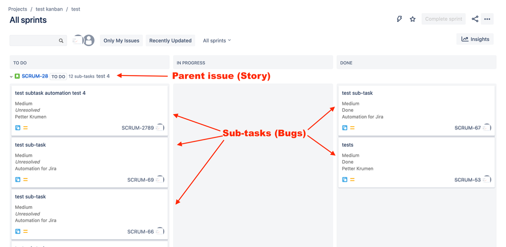

  3. This is how your active board will be displayed:
Let us know if this is the feature you are looking for.

Thanks, exactly were I was looking for.
Somehow it is not possible for us to configure the lane on story's, but we are able to configure the lane on Epics which has an collaterale advantage in our project.
Because of the multiple sub-projects, now we have a clear overview without filtering.
