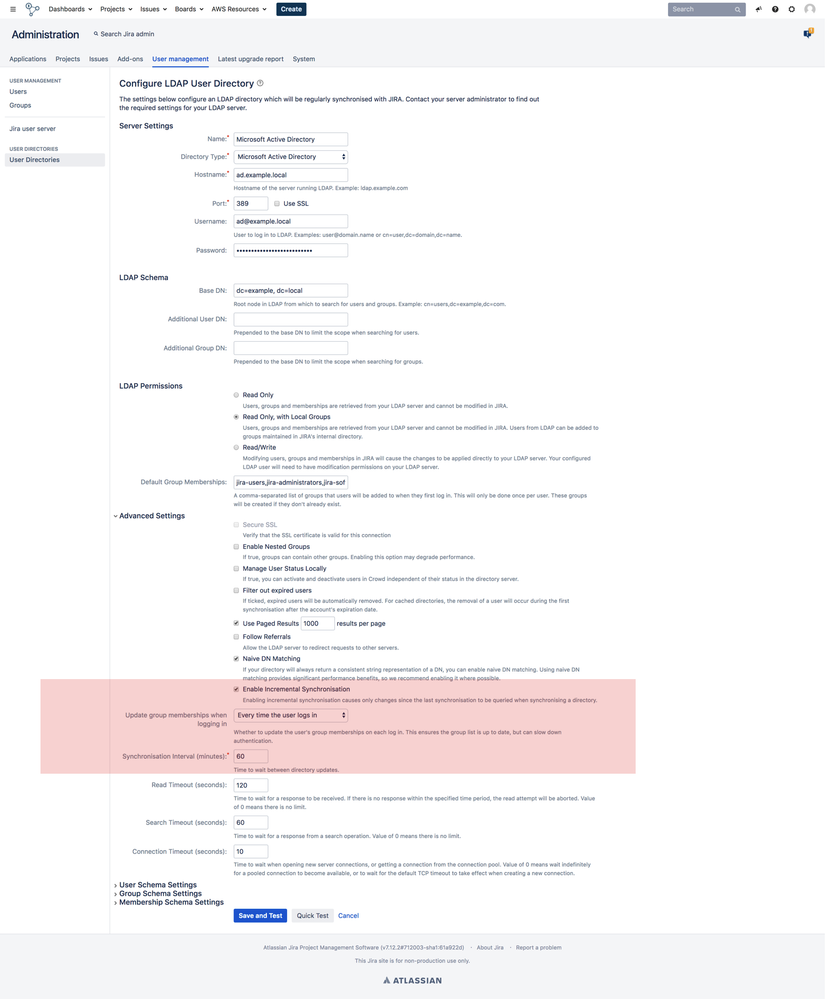

Jon Espen Ingvaldsen Kantega SSO
October 17, 2018
Slow logins like this is commonly caused by group membership updates transactions sent back to the user repository at login. Is your user directory set to update group memberships at login (see marked area in attached screenshot)? If so, do logins go quicker if you change the settings to never?
Regards
Jon Espen
Kantega Single Sign-on
Simon H
October 17, 2018
We're not using an external directory :(
