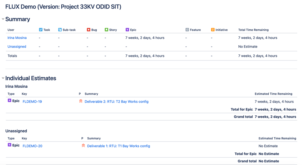

Version Workload report works for all the issue types that have Fix Version field associated with their screen and people actually specifying it, as in allocating those issues to the version.
So if historically you were only allocating Epics to the version (see example) then that's what you will get.

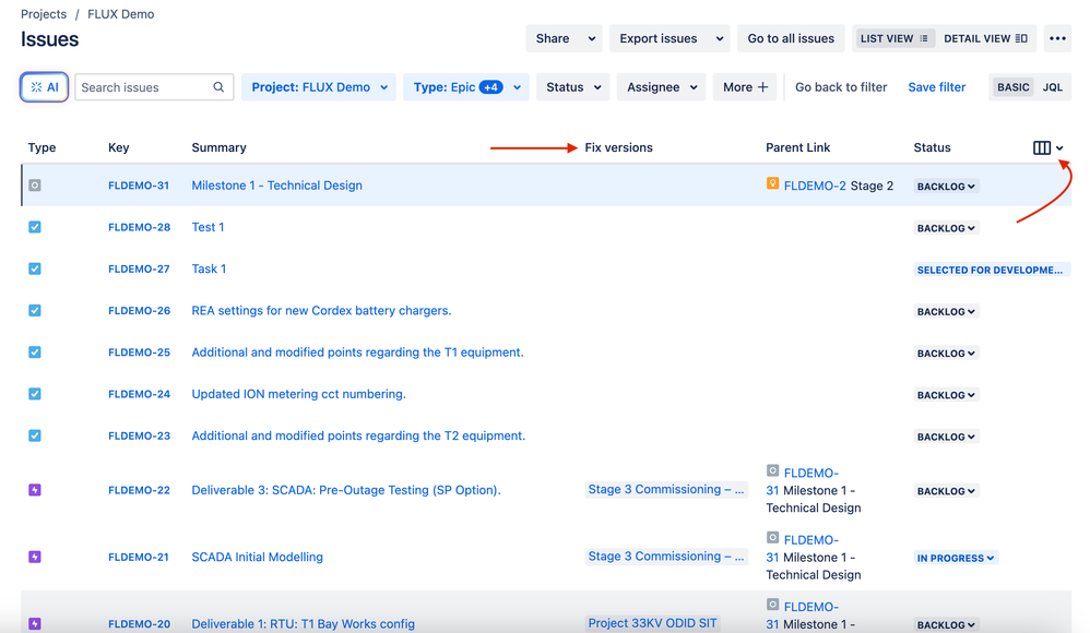

I suggest to go to the side panel in your project, click on the Issues icon and run a quick search where you select an extra column, Fix Version and see what you got there:
