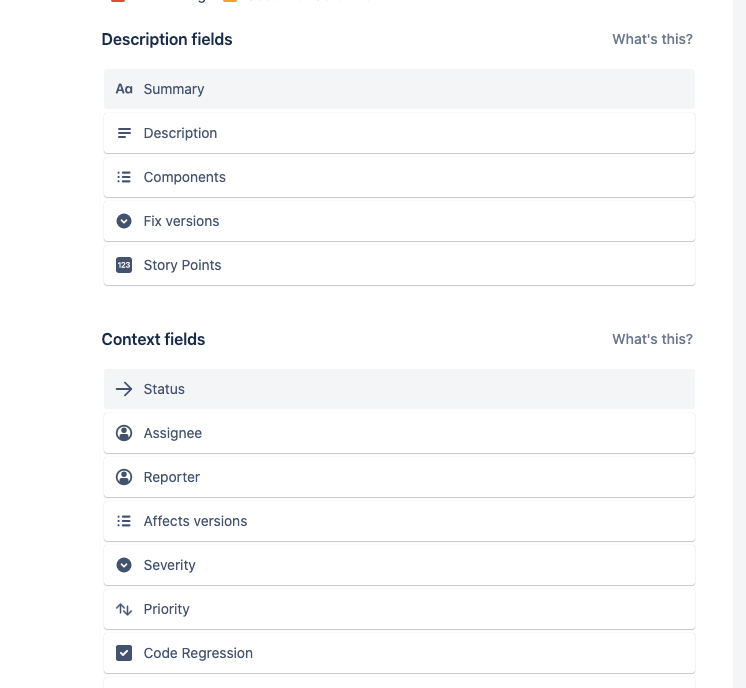

Michelle De Mott
January 4, 2021
Hi thanks for responding,
I can only drag the item into the version on the backlog view.
In the ticket view, version is not showing, even though I have it configured to show as a description field. Screenshot 2021-01-04 at 17.04.01.png

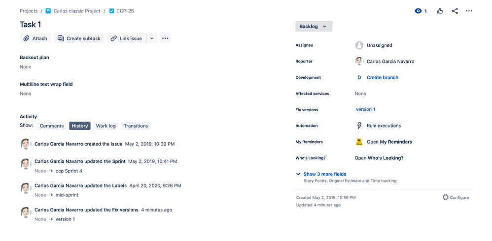

Carlos Garcia Navarro
January 2, 2021
Hi @Michelle De Mott ,
That's strange. Are you looking at the field 'fix versions'?  I just tried to reproduce the same issue but unsuccessfully. It would be interesting to see if the 'fix versions' field changes. Can you check the history for the ticket in question when you move it to the corresponding version? Thanks
Michelle De Mott
January 4, 2021
yep looking at fix version, Interestingly it had the history stating it was assigned to the version - but not visible.
I deleted the versions (trying to find the issue) and they said they had 0 issues on the version view. Then when deleting, JIRA asked me where I wanted to assign the issues from the version when I deleted it !
