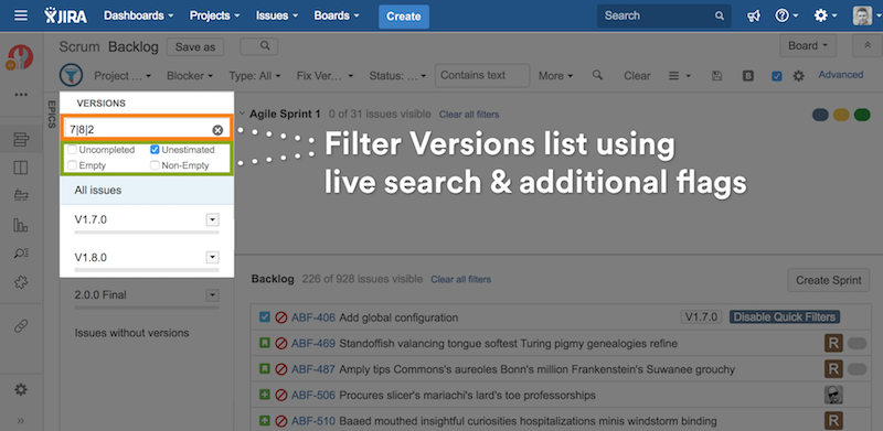

Prem Chudzinski _extensi_
Atlassian Partner
November 3, 2017
Take a look at this
https://extensi.atlassian.net/wiki/spaces/ABF/pages/31850177/Epics+Versions+Lists+filtering+on+Backlog
  • Restrict the version or epic list by Project key for example: KEY1|KEY2|KEY3
Filtering will be saved so next time you'll open the backlog versions or epics will be filtered out by project.
