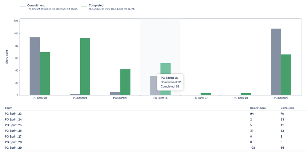

I have observed inconsistency in data with respect to actual committed and completed story points on the velocity report across various sprints. Is this a bug or are there specific considerations to be made before starting and ending a sprint?
For example, the team made a commitment of over 50 story points during the start of a sprint and completed most of the stories, but the velocity report shows 0 for the commitment and 3 for the completed stories. (See attached picture).Screenshot 2024-05-30 at 13.08.21.png

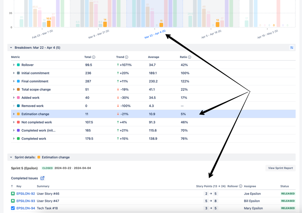

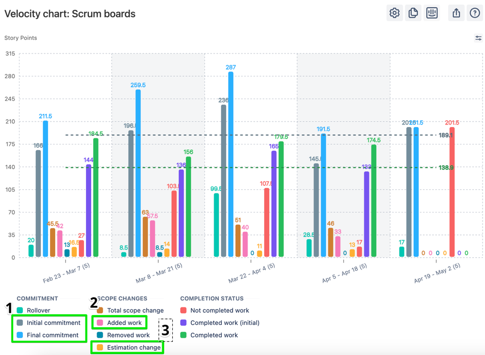

To investigate what’s happened, you can try (for free) the Velocity Chart Gadget app  because it shows much more than Jira:
If the issues are not counted as Initial Commitment (they equal the Jira grey bar) and appear in Final Commitment (1), you added them after the sprint date. They will also be counted in the Added work metric (2).
You will see this in the Estimation change metric if you added issues before the sprint started but estimated them after (3).
To find all these discoveries, you can click on specific sprints and needed metrics to see the issue list in sprint details:
Then you can investigate, issue by issue, why it isn’t counted as completed. It can also be because someone has changed the sprint start date.
