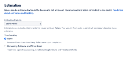

HP
July 23, 2019
Hi @Warren ,
I read the dicussion and got even more confused. Why did JIRA created these two fields that just create more distraction?
Looking at my board setting, I'm estimating correctly for Story Points (April worked out fine).
Then JIRA introduced this new field and it stopped tracking the committed.
I guess I need to try with estimates and see what happens, but this is plain confusing.
